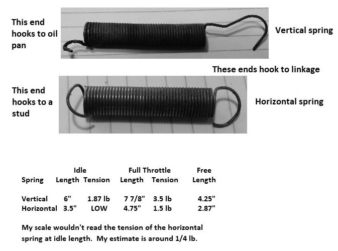

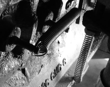

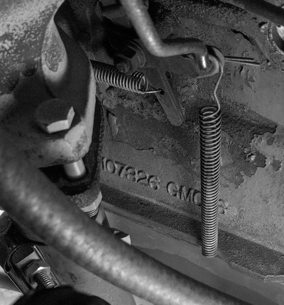

  11. Bill Hanlon
    2,747
    Fredericksburg TX
    First, let me say that I have no idea if my springs are original equipment, but the pressure required on the gas pedal seems reasonable to me.

  13. Bill Hanlon
    2,747
    Fredericksburg TX
    Forgot to put it in my earlier post. The spring wire was 0.055" diameter on both springs.
  14. 51gmc100
    51gmc100 Member
    Feb 12, 2022
    Dandridge, Tennessee
    Just what I needed. I’m ordering springs from McMaster Carr now Thanks again for getting me the information bill When ever I get back through Texas I owe you a few beers.
