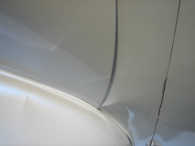

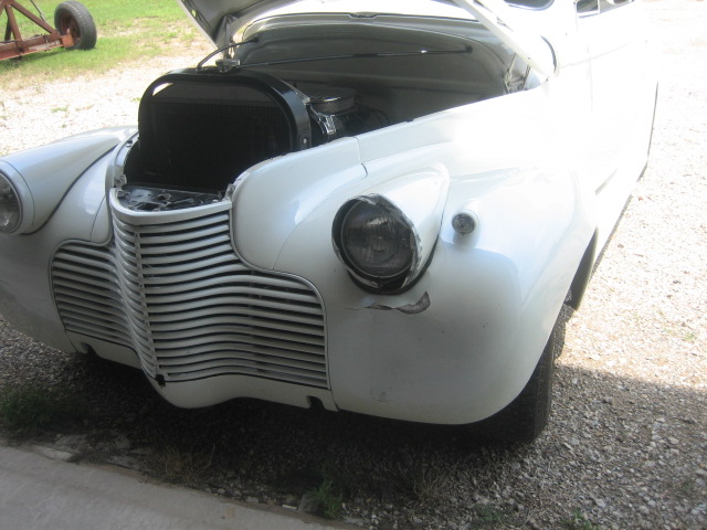

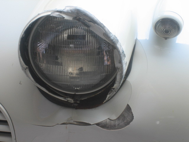

    A customer's 40 coupe was wired up without a neutral safety switch (not by us) with the incident of jumping forward and biting his office wall. The adjuster quoted the damage at $6k and with the tri-stage pearl paint it will probably use that amount up. All with auto trans should do themselves a favor and wire in a NSS. It's easy to do with a universal type starter button that gets pushed by the trans linkage when the trans is in park. If you have a later steering column it already has one. Just run the wire from the switch to the solenoid through the switch and save alot of headache.

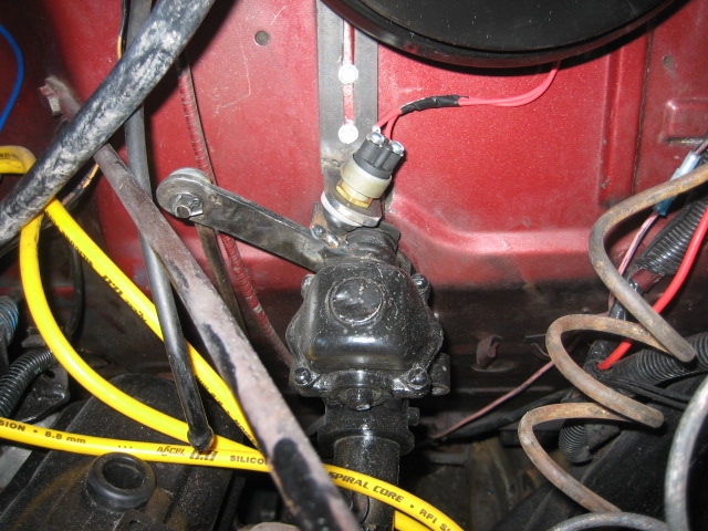

    Here is a sample of a simple neutral safety switch when using the stock AD column with an automatic.

    Is to leave the clutch pedal and wire a switch to it so the starter operates only if the pedal is held down...... :)
