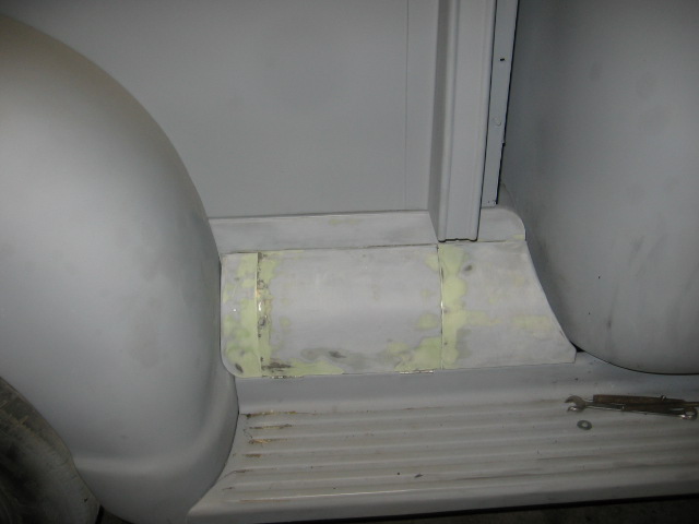

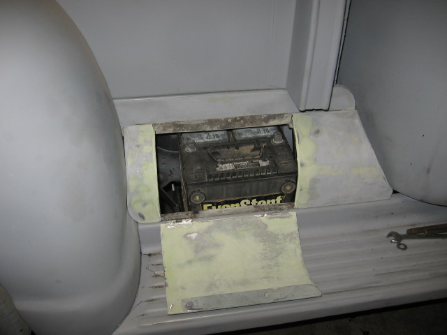

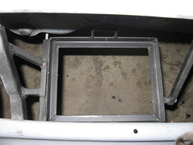

    I needed to relocate the battery, as a result of putting the 53 on an s-10 frame. the frame got in the way of the stock location, so I decided to move the battery under the bed on the passenger side. What do you think??

    Looks pretty good ! . remember to use # 1 gauge cables and NO clamp on ends!
    Back in the day , the undercab battery tray would rust out and we'd get an old galvanized & insulated steel milk delivery box , punch two holes for the battery cables & bolt it to the running board , this was a very common thing to do in The East as the box kept the battery's from freezing & splitting if they went dead .
    Cheap too , always a good thing on the Farm .

    That's is a way cool idea! I remember knocking around ideas about where to put a battery, too. Never thought of that solution~ Thanks for posting the pictures Herman!

    thanks for the kudos guys.
    Flashlight- I did something like that once. Went for a quiet walk in the woods with the Misses,only for her to discover it was an old landfill... you know the rest
    Nate- how to you connect the cables with no clamps??

    You guys ! :rolleyes: no need to rob the milk box off the neighbor's porch , they're scatted all over the East Coast in trash piles , junkyards , thrift stores and so on , no one uses them since the late 1960's.......
    I even see them in Cali. from time to time .
    I didn't say not to use battery cable clamps , I meant to never , EVER use those stupid clamp on ' repair ' end things as they always cause problems .
    Side mount batteries should always be avoided , they were junk when GM invented them and remain so 40 years later .
