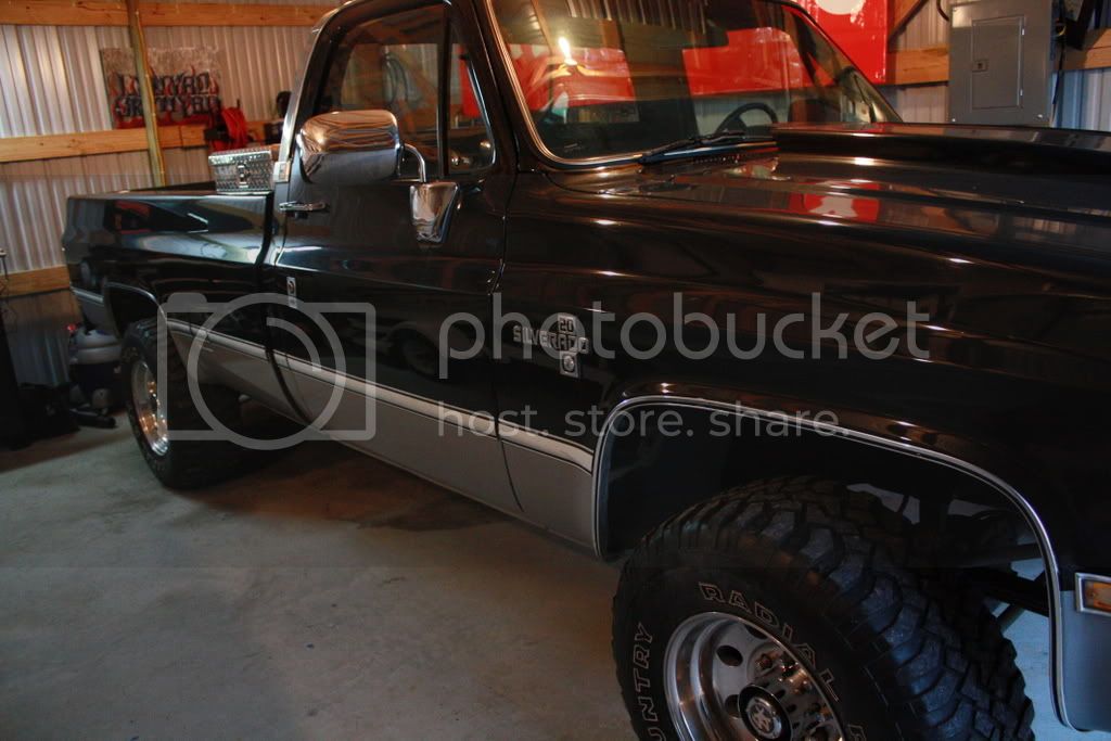

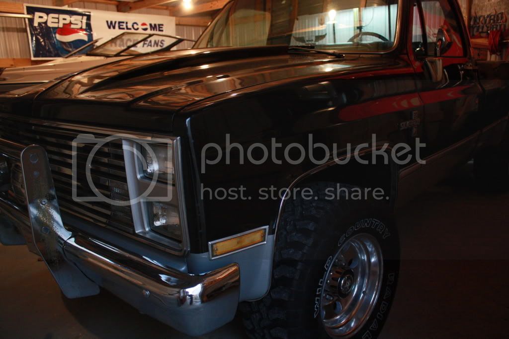

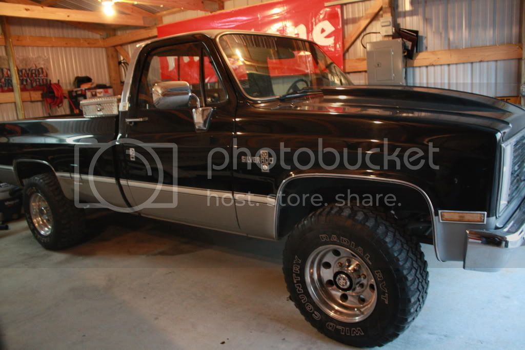

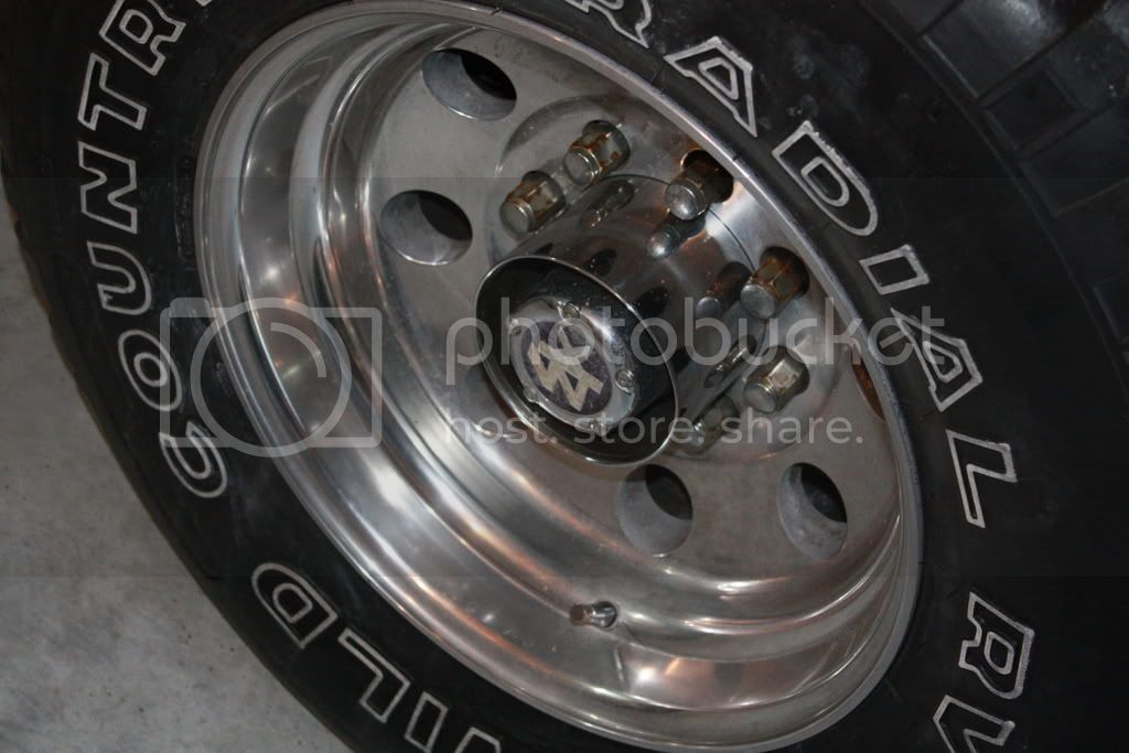

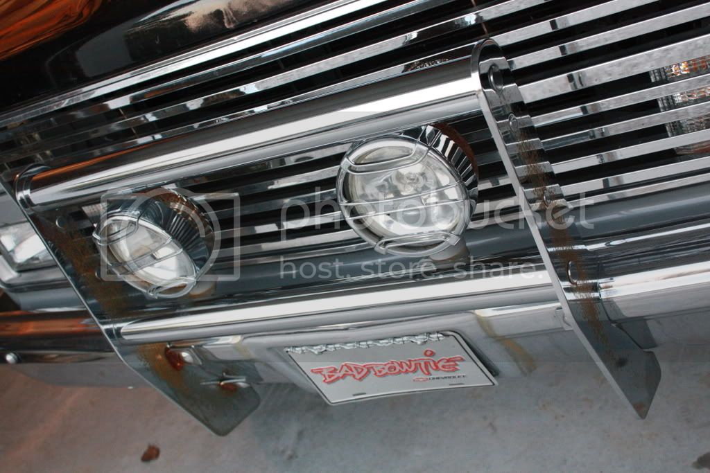

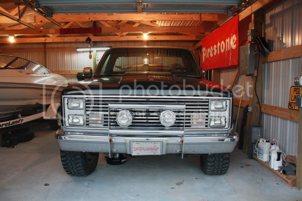

    Basically, Im looking for a way to pep up my 350. Let me know what you guys think and here are a few pics.

    Howdy and welcome....nice truck you got there.
