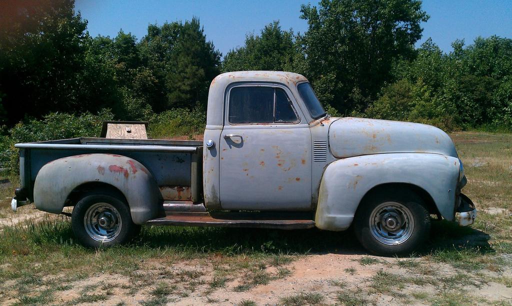

    couple pics

    Great looking truck. Enjoy

    nice truck. Enjoy

    Good object !
    Thanks for sharing your photos.This gives you a pretty good start. What is your impression of the trucks total technicall condition ?

    Buy the way That 55 truck looks awesome , thanks fore sharing your photos apoe.

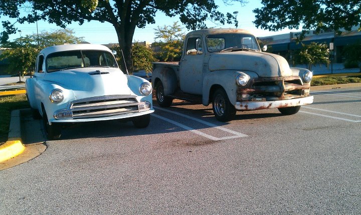

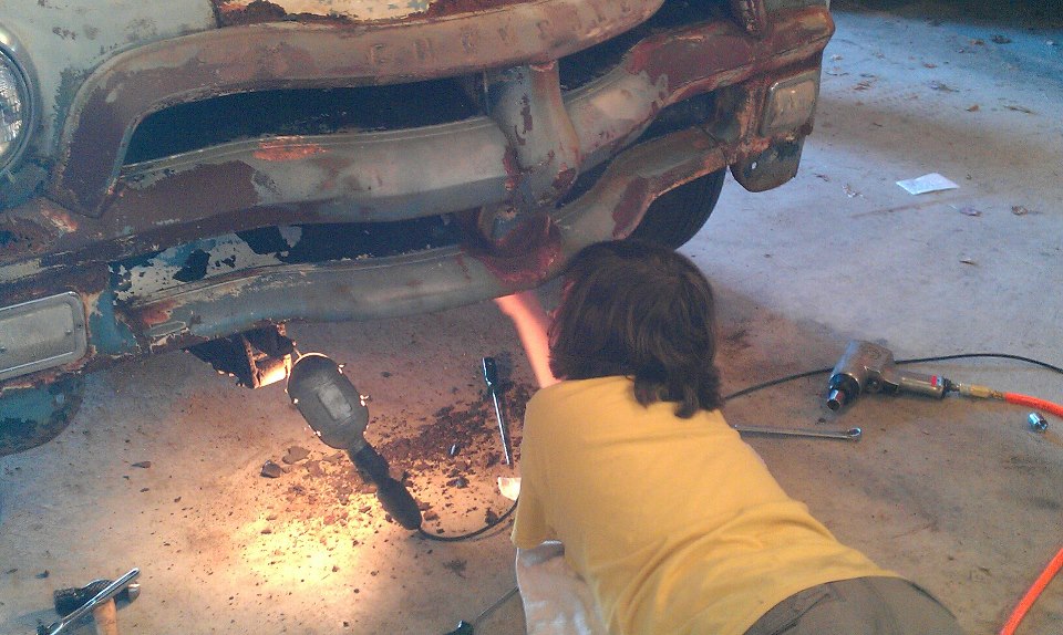

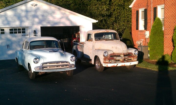

    cut that off weeks ago sounds good.
    couple pics from last weekend.
