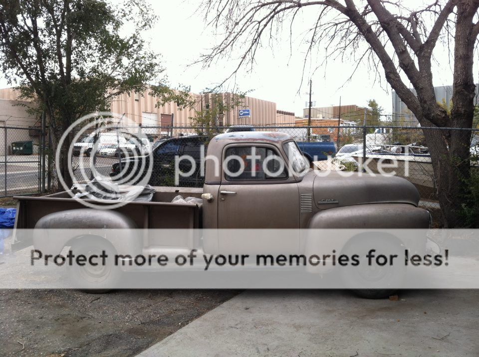

    Hi - My name is Dickson, and I have a "new" 1951 1/2 ton GMC truck.
    It's very original and pretty solid & complete. However, the engine is missing.
    I've been told a lot of things from "put in a Chevy 235" to "drop in a 350"...I think that I'd be very happy with an original straight 6 GMC motor.

  2. ccharr
    Welcome Aboard Dickson, enjoy the ride while you are here. Drop what you want in there if you want to keep it stock stay with the G motors.
    It's your truck and it looks like a real good start. Thanks for sharing.

    4. nope. It came with a 228 so the bigger ones should be just fine, also
    You'll probably get all kinds of ideas here, but with a truck that looks that good, keep it simple...

    And, say WHAT??? ANOTHER GMC???
    This is just too good!!!!
    That looks like it's mighty darn straight, also!!!
    WELCOME!!!
