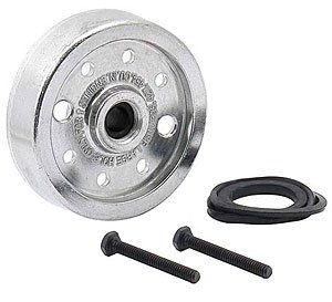

    The 283 in my 66 has this adapter (was leaking) and I also snapped a pic of what the block looks like.
    There is a hole in the block picture about 1 o clock. And the plastic black piece is pretty hard, should it be rubber and more plyable?
    I was using a K&N oil filter which seems to seal well against the face of the adapter.
    Am I missing some other piece?
    If I were to replace this assembly, what should I use?

  3. LDO
    LDO Member
    Jul 7, 2011
    142
    MS
    So Rich, the part in the pic you posted is all i need? No bypass valve or anything like that?
    There is only the small diameter seal that I hold in my hand no outer larger seal? The thing was full of orange permatex rtv around the outter edge, a total mess that was leaking oil.
    I thought to myself, all this rtv and yet, still not enough...:D
  4. Rich 5150 69
    Rich 5150 69 Member
    Oct 1, 2008
    334
    Nor Cal
    I belive tou use the standard oil filter for a small block chevy, I`m sure the instructions will denote which one to use, the SM Blk chevy uses a perimeter seal at the edge it comes with all oil filters for chevy...

    Got the girl running today and zero leaks!!!
