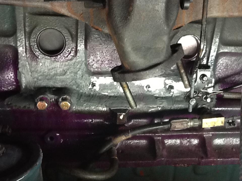

    The repair
    Hello,
    So, I thought about how to repair the block thoroughly and ask an old school friend of he is an engine builder should I let weld the crack in the block or not. He told me that I can do this if I find one who is a specialist in cast iron welding. He told me that he had no one in my area.
    Some friends of me are owners of a iron foundry. They told me they give their parts to Hannover to an institut, but they said there will be always a risk to weld an engine. It can be okay and everthing will be fine but it can also be that you will have after welding a banana, an crooked block and this will be very expensive to get it right. They gave me an adress for a factory which sells cold welding products and they close with that gas tanks who have a crack. Here the internet address:
    http://diamant-polymer.de/en/products/multimetal/
    I cleaned the the part of the block where the crack is very careful with aceton, mill cut the crack on the hole lengh a little bit, drilled at both ends of the crack a hole and cut a thread where I screwed screws in it which hold on a sheet metal.
    Between the metall of the block and the sheet metall I put the cold welding 2-component repair system. After waiting 2 days to let the paste will get hard, I sprayed a substance which is called Dichtol, here the address:
    http://diamant-polymer.de/en/products/dichtol/
    I made last week a test drive and looked if the part around the crack is dry and it was.:D
  10. wokri
    wokri Member
    Jul 14, 2008
    325
    Germany
    Here a photo of the location which was repaired.
  11. Blueflame236
    Blueflame236 Member
    Mar 29, 2008
    1,555
    Norway
    Amazing product range!
    Wolfgang
    I am so glad on your behave that you sucseeded finding a Product that gives this promizing result.This without any spesialized help . These Products are well documented:) Congratiolations. Thanks for sharing Your photo.

  13. ccharr
    Thanks for the info Wolfgang and the photo.
    Charles
