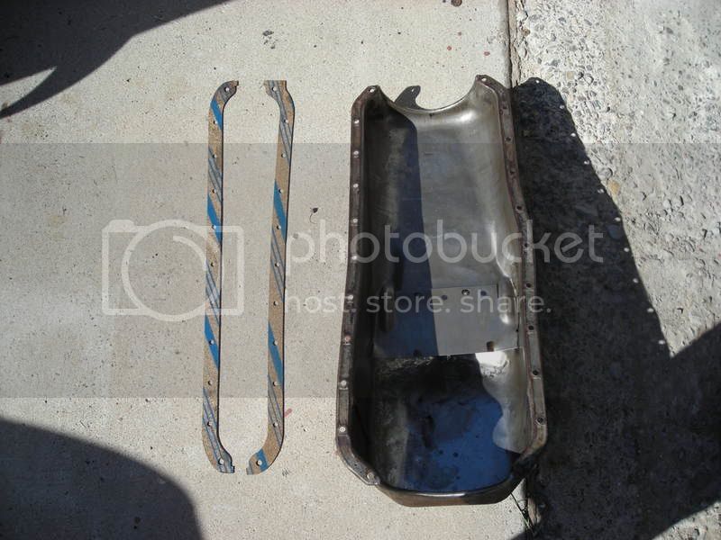

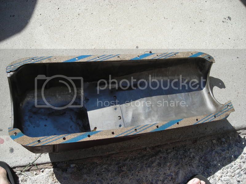

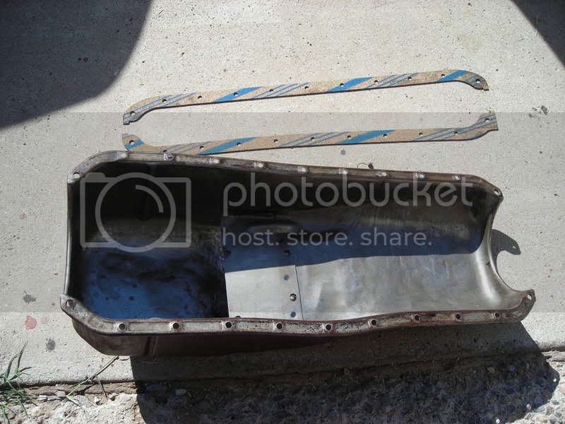

    ok, got some pictures. it looks as though the gasket is very straight, whereas the oil pan has some curves in it, which may cause some problems. is this normal stuff, or do i need a different gasket maybe? thanks!!
    jon
  12. vwnate1
    11,677
    ?? looks good to me ~ add the end pieces and you're good to go .
    That's a '55 and newer full pressure 235/261 oil pan there...

    Nate, unless I am seeing things different than you are, that gasket does not look correct. The holes do not line up the way they should. I also believe the one side gasket should have the curved shape to match the pan already in it, not bend to fit. Not sure if I remember right, you have much more experience with them than I do, but it just doesn't seem right. Any thoughts?.........Mike

    yeah, mike. that was my concern. i can get the four main ones to line up, but not the rest, or vice-versa. doesn't seem right, but i dunno. thanks

    You are correct , they sold you the WRONG gasket ! it doesn't match atall , go take it back , this is from your FLAPS , right ?
    NAPA Victor P/N : OS31116 fits 1955 ~ 1962 ALL . this is the good rubberized cork gasket .
