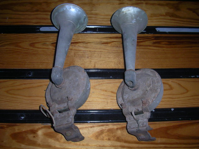

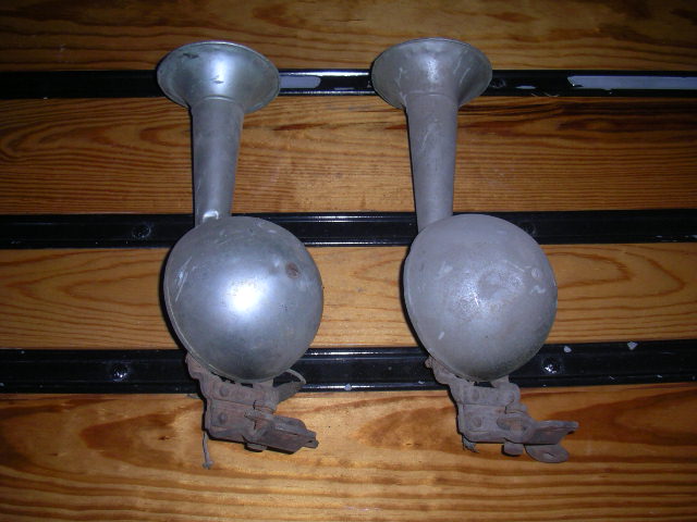

    I picked up a pair of old horns at an estate sale for nearly nothing this morning. Chrome over brass with iron bases.
    Any opinions on what I might have except conversation pieces? I am wanting to clean them up and possibly install on thunder just for a few extra grins.
    All opinions are welcome, so let me know how much of my lunch money I wasted.

    I will have to find room for them if thye work. The wiring is frayed, will need replacing. I am going to disassemble the horns, clean them up and reassemble, then figure out if they work.
    If not, I will hang them up shiney somewhere because they are very cool horns.
    I hope to figure out how to firewall mount them, or hide them inside my grille (where they can peek out a bit).
    Jim

    Resist the urge to take 'em apart as they're easy to return to service :
    The domed cover has a screw , remove the cover then clamp the base firmly into a heavy vise ~ it is critical to dampen the base or the horn won't sound correctly ! .
    Energize it ad see if it toots ~ if not , use the heaviest plastic handled screwdriver you've got to shock the body by whacking it , holding the screwdriver's tip ~ this usualy shocks the points into operation .
    if not , connect a test light in series with the power lead (you know a batttery charger won't work to test horns) and if it lights , ever so gently turn the points adjusting screw until it just goes out , then back again and re-test the horn sans testlight .
    Be are that for any horn , 1/8 a turn of the adjusting screw is a HUGE amount and you can easily wreck it beyond repair by mindlessly turning the screw thisa-way and that .
    If the points are too corroded to come back to life , most of the time you can take them apart and carefully file using a burnishing tool , wipe hospital clean and re-assemble , adjust with the test light .....
    It's easy to loose or misplace a fiber insulation washer though .
    most of the time , once yo get it to growl or hoot , just tooting it long & loudly , will get it back into shape , maybe a 1/16 of a turn on the adjuster screw .
    Some older trumpet horns have a little rod that pushes agains the diaphram and it bends occasionally , making the horn squawk instead of tooting ~ remove the rod and straighten it , all will be well again .
    If , in spite of all your hard work , a horn toots off key , not to worry ! adjust it to the loudest it'll go and find another one with a different off key tone and wire them as a pair , you'll be pleased at the melodious tone both off key horns produce when tooted simultaniously :)
