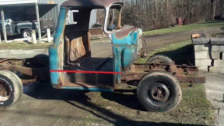

    I also cut away the inside spot above the windshield and dug out all the nest. Wanted to really blast that area well.
    Swiss cheese. :-(
    Looks like I'm going to be replacing everything from the red line down.

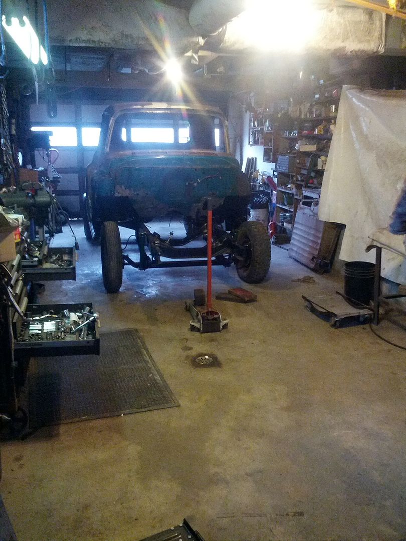

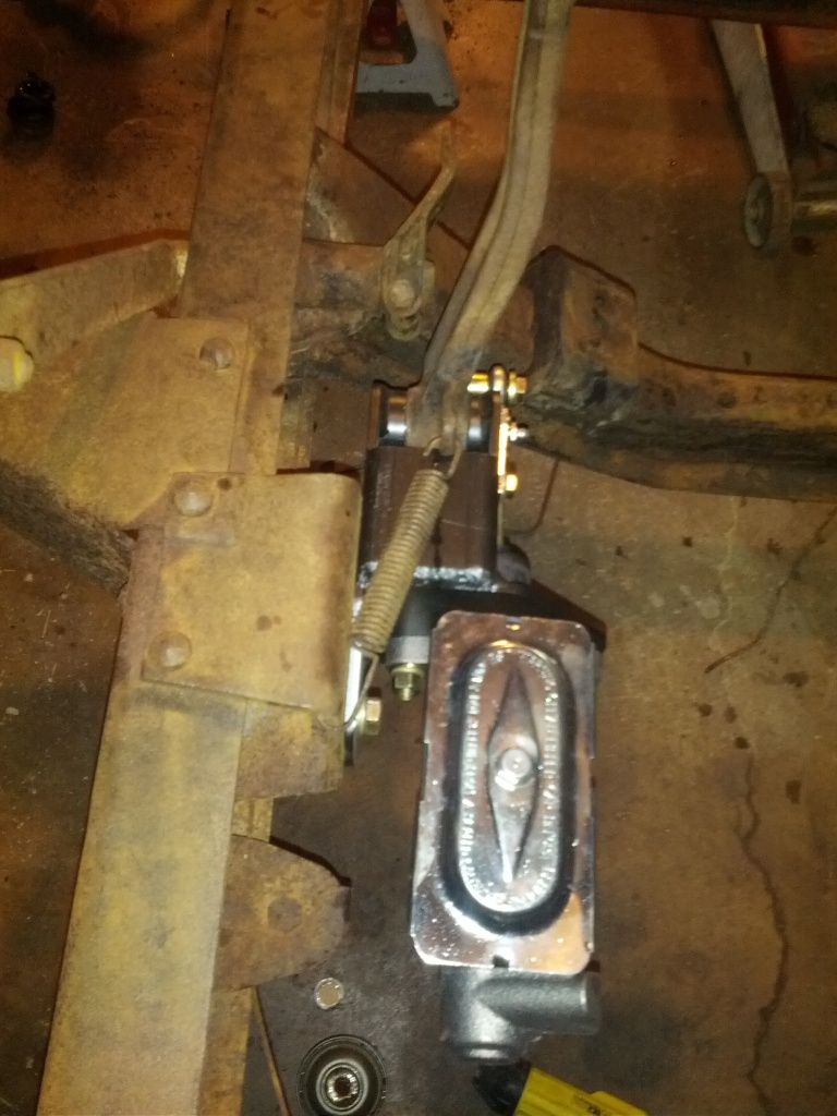

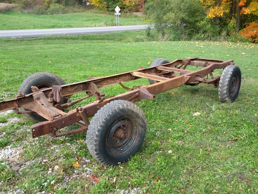

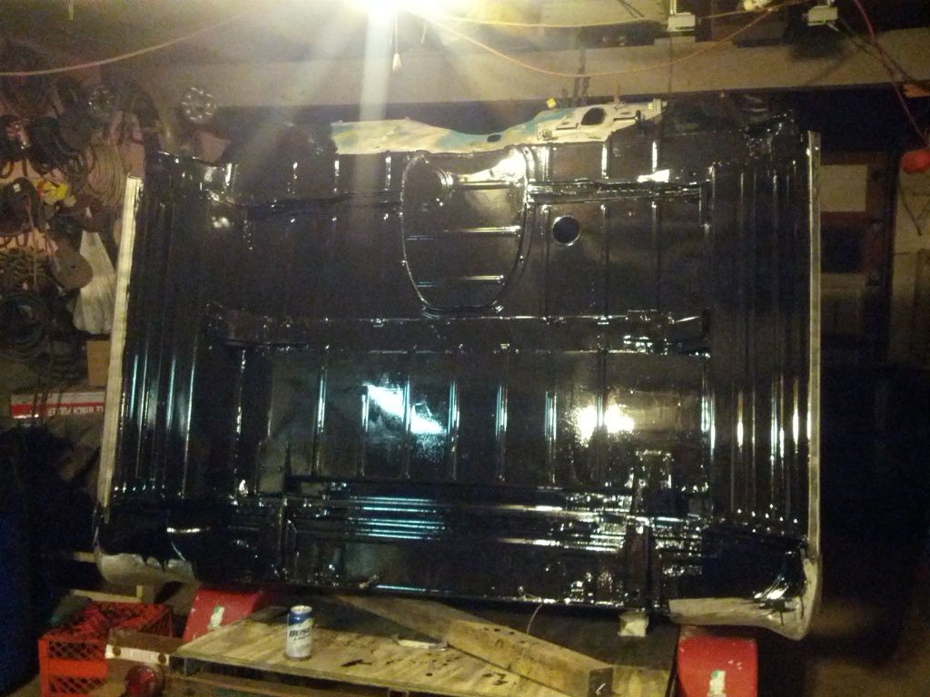

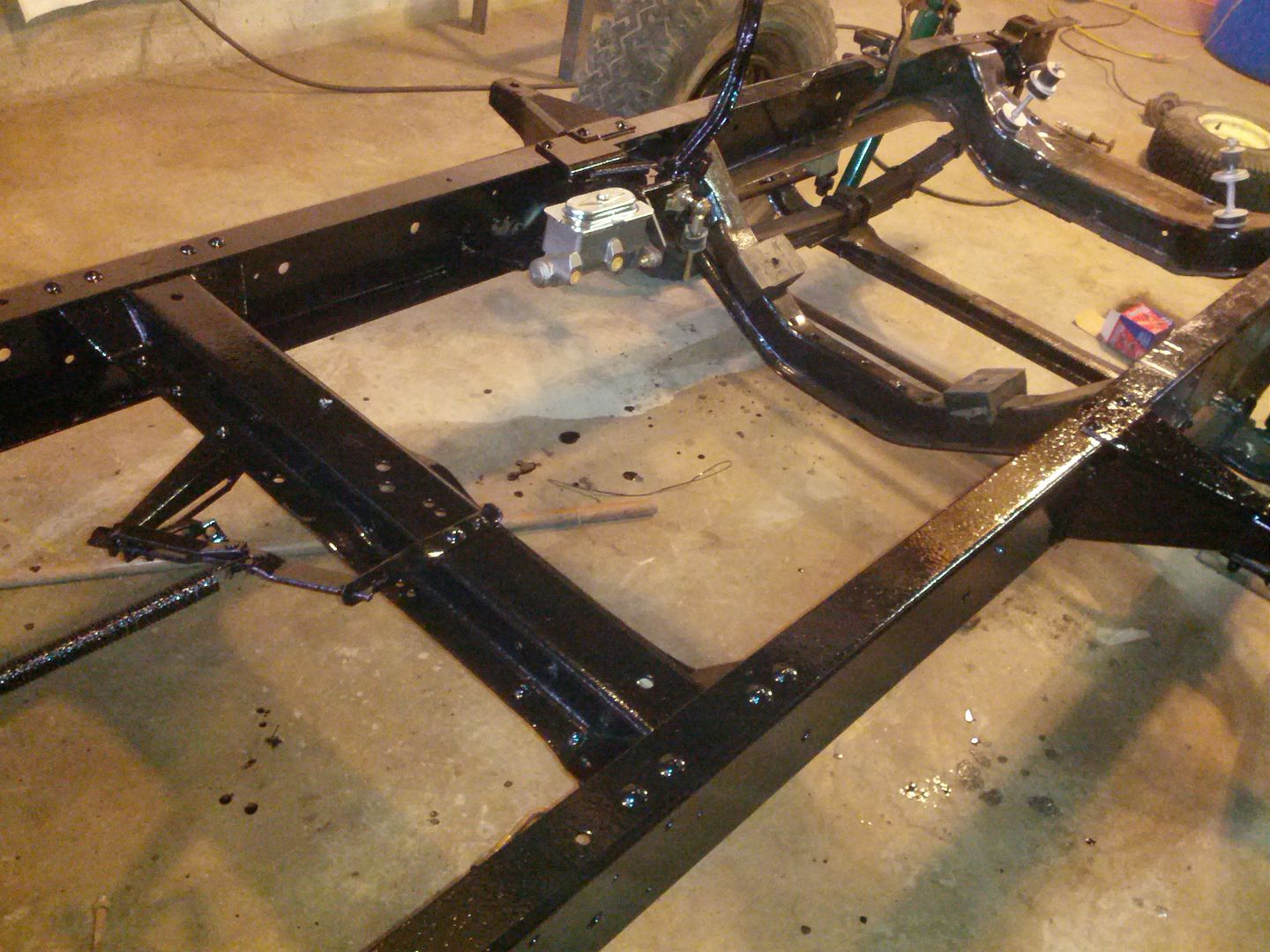

    Pulled the cab off of the frame and set it on the back panel so I can seam seal and paint the floor with por-15.

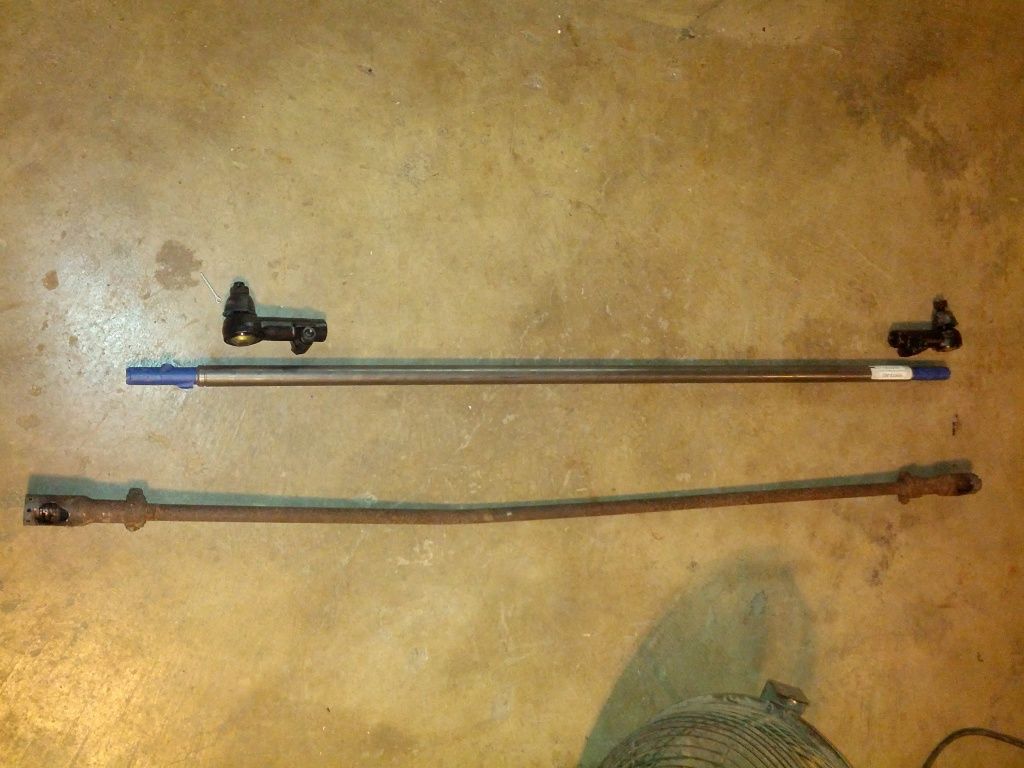

    While the frame is open I installed the dual chamber master cylinder set-up. Dropped in real simple. Also installed a heavier tie rod with modern ends.

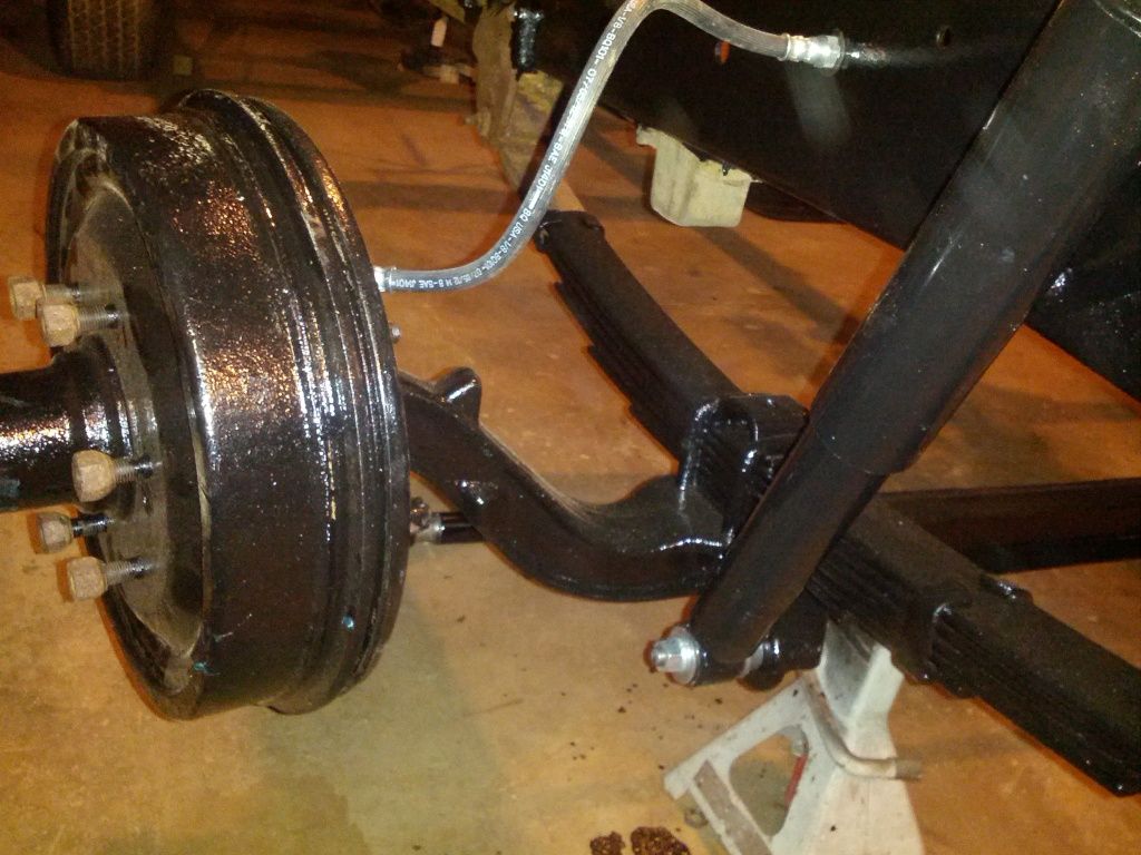

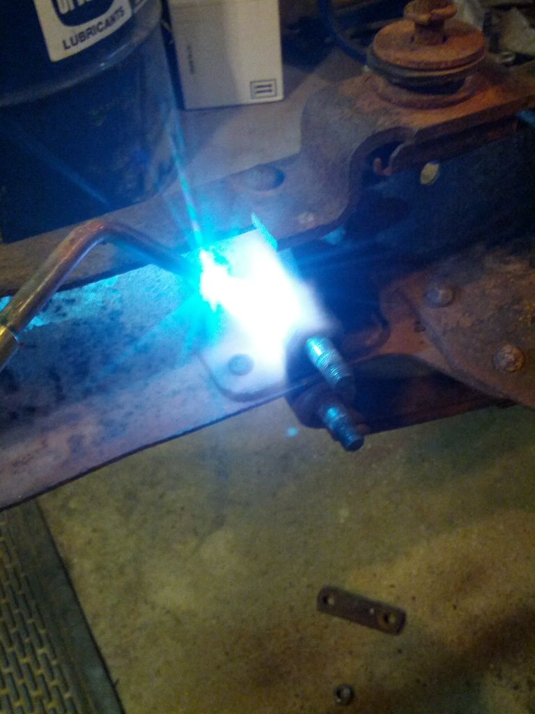

    All the pins and shackles were worn out, stuck and won't take grease. Tip here: if your going to replace front shackles. Buy the harder to find later style that has nuts on the outside of the plates. Much much better set-up than the taper and carrage bolt on the earlier ones.
    After thats done I start running a wire wheel over the frame and start brushing on more por-15. Picked up brake shoes, wheel cylinders, brake hoses and some 3/16th steel line form the local auto parts store.

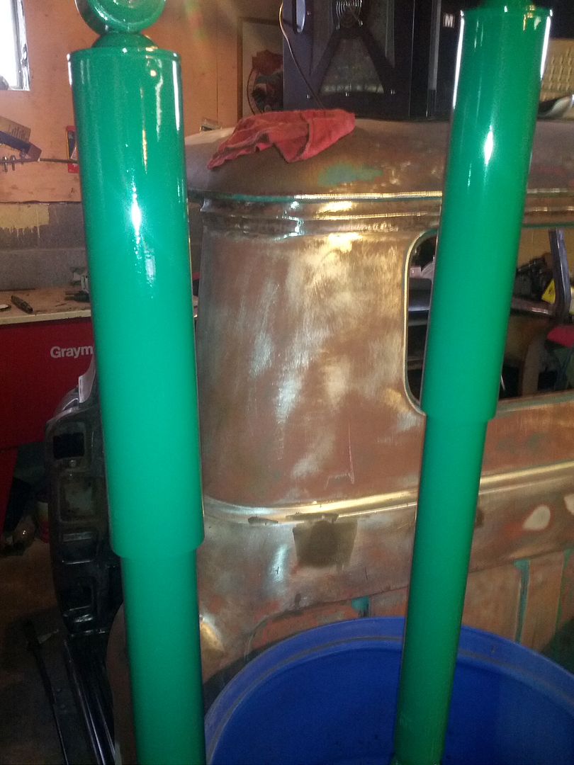

    Painted the shocks XO Rust green. For rattle can this stuff really dries slow.

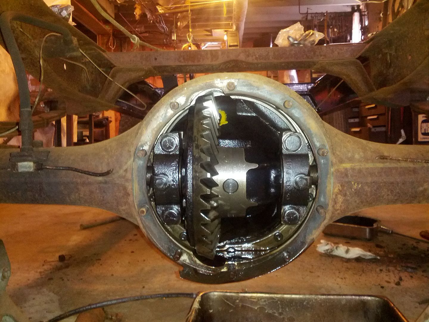

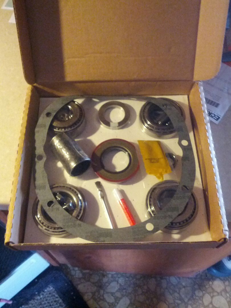

    Right about this time a friend of mine stops up to check out my progress. He grabs the pinion of my differential and shakes it all around. "Your gonna rebuild this, right?".
    Well crap, hadn't planned on it. But if it's bad its bad.
    I really don't know much about differentials and lucky for me he did and offered to rebuild it for me if I bought the parts.
    Cracked the rear end open and orderd a kit for the diff.
    The kit was lacking in a few areas. Only came with a gasket for the diff side, not for the cover side shown removed above. Also the crush sleeve for the pinion didn't work well and I ended up machining one out of some round stock.
    Finished coating the frame with por-15. Highly recommend wearing gloves with por-15. It will take a week to get it off your hands.

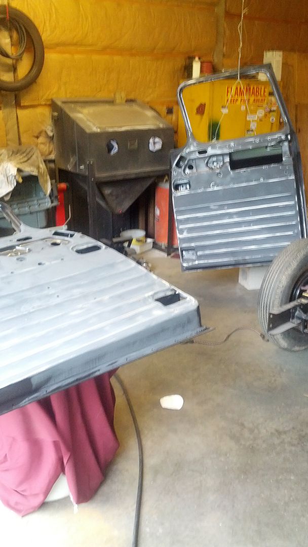

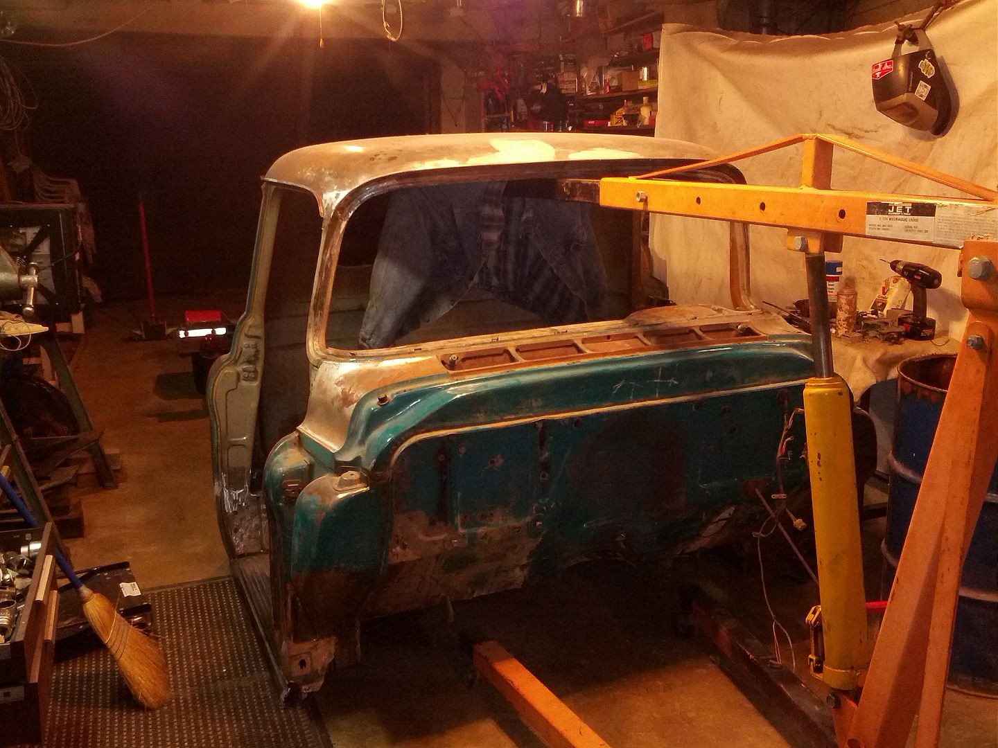

    Now that the frame is painted the cab can go back on. I made a "T" end that goes on the end of my cherry picker for picking up the cab, makes it a one man job.

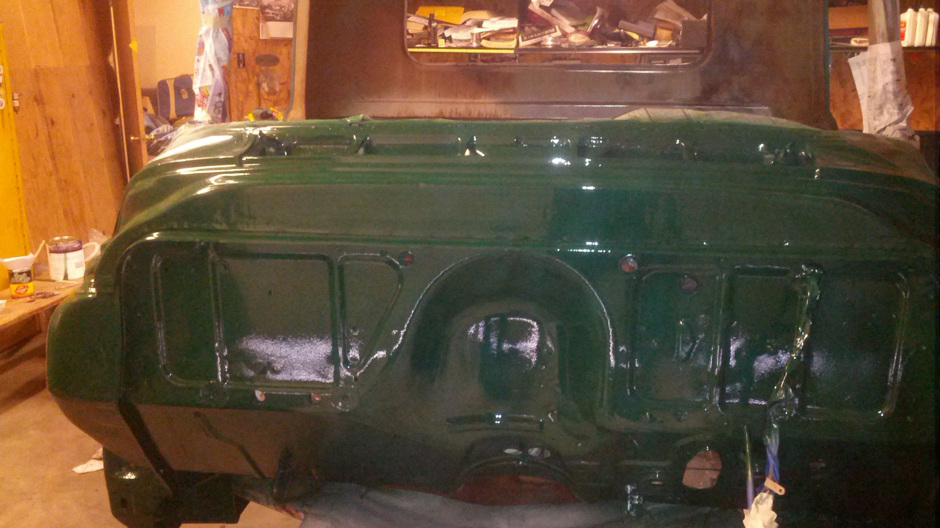

    Ordered some epoxy primer from Summit and decided to get hopping on getting some paint on the firewall. That way I can go ahead and chuck the motor and trans in.
    Primer shot on real well. My bodywork experience is all pre-epoxy and HVLP, so I've been doing some relearning.
    Got some urethane paint in British racing green from paintforcars.com and the price was way better than the quote I got from my local supplier, even for their "value line" of paint.

    Gotta say, seeing the green on there lit a fire under me and the desire to get things done before cold weather sets in. Figured the green went so well that it's time to do the interior.

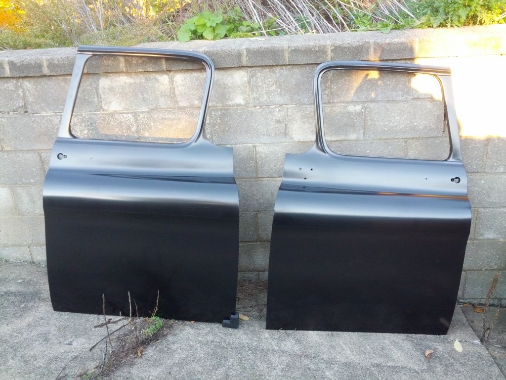

    It's also worth noting that at the same time I'm trying to work on my doors at the other shop. I had them hung on the truck for the cab corner install, but they need some work. Thing is they are a little rusty and whether they are a little rusty or a lot rusty it's the same expensive/labor intensive repair panels. So in a fit of frustration I called a friend up that owned a body shop and asked what the "good buddy" price on a set of new doors would be.
    Well I sucked it up and bought two doors. They are Dynacorn doors and seem a little light/flimsy in the hinge area when mounted. We'll see if this was money well spent or not. "in for a dime, in for a dollar" ordered all new hinges from Classic.

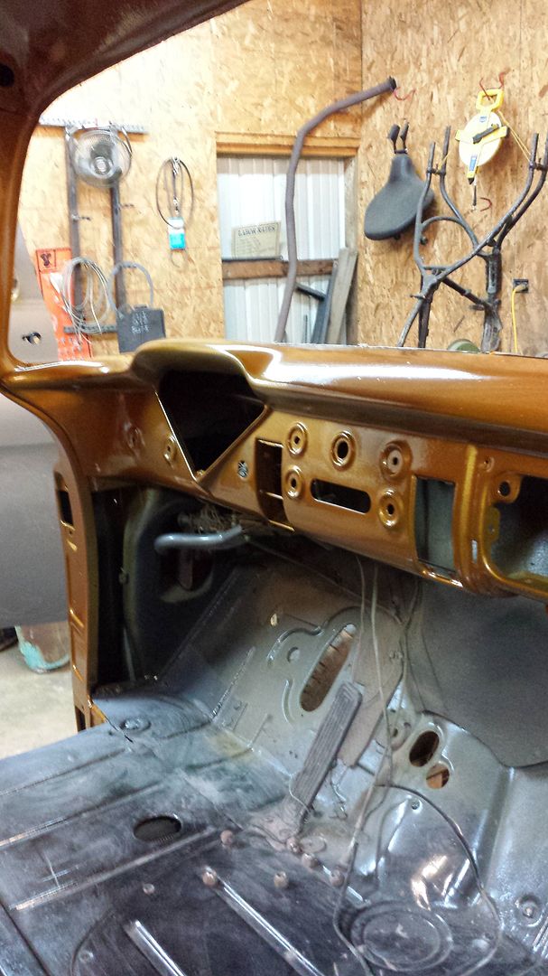

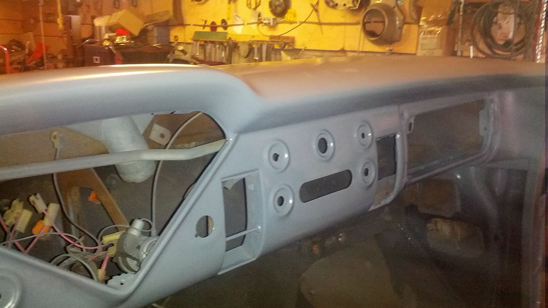

    In prepping for doing the interior turned into quite a job with making sure I didn't forget anything ( ashtray, trim next to door glass, trim at base of windshield etc.)
    When I ordered the green I also ordered a gallon of Myan gold for the interior.
    Had a bad day of painting. I think every thing that could have gone wrong that day did. I mixed the first batch wrong causing it to be too dark and not lay down as smooth as the green did, some foreign material got in there from somewhere and my air compressor decided to cough up water.
    It's on there and it's done and now that some time has passed I don't notice the flaws as much and the darker color is growing on me.
