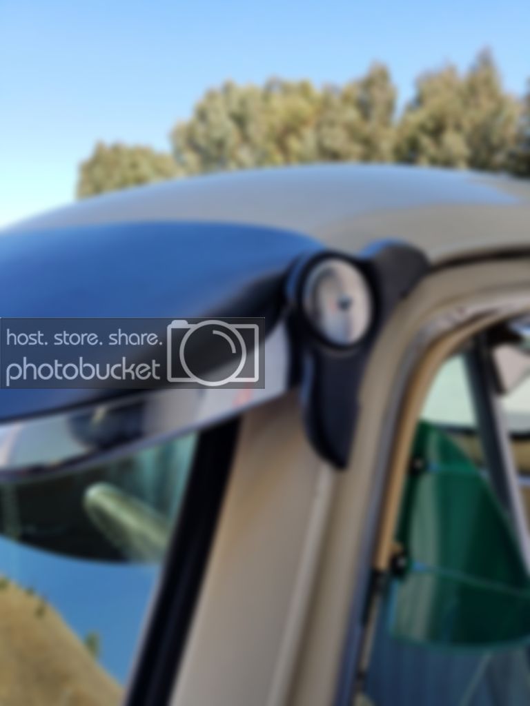

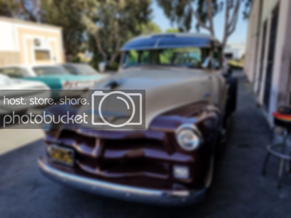

    I know its a old thread but had to say something. I love the look of Fulton visors and did not want to go with a one piece on my 54, I was lucky enough to locate one from a friend with the roof mount and NOS in the box still
