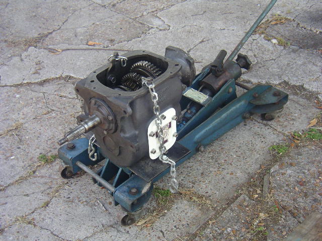

    I have cleaned up two original SM420's both were unfinished cast iron.
    I cleaned them up real well and painted them with "cast blast" paint that looks like cast iron, but doesn't rust. My tranny looks nice enough under my truck tied to my Chevy blue bell housing.
    Jim:D
  10. brit 50
    brit 50 Member
    Dec 6, 2005
    1,202
    Essex England, the motherland
    Jim
    Throw that jack out, the correct way to install the box is on your back with it on your chest, make sure your on firm ground tho, or you will be pushed into the ground:D
  11. Zig
    hmmmmm...
    I found evidence of a nice GMC red on my bell housing and transmission. Maybe this was part of that extra attention to detail that Gs got?:rolleyes:
    Nice job, Jim!

  12. Zig
    ...on top of brit's quilt-wrapped Mrs. ...:rolleyes:
