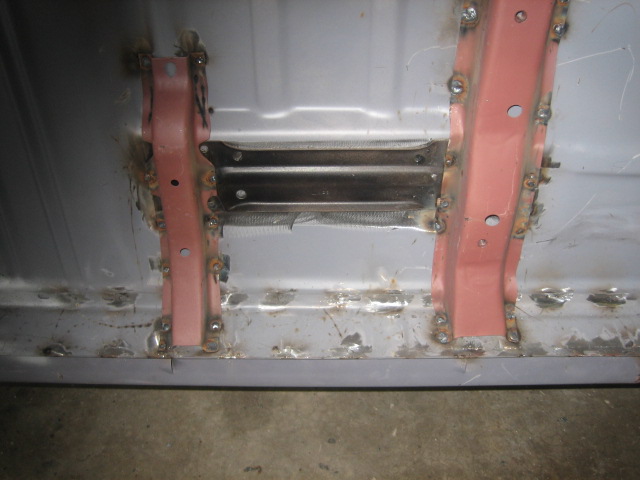

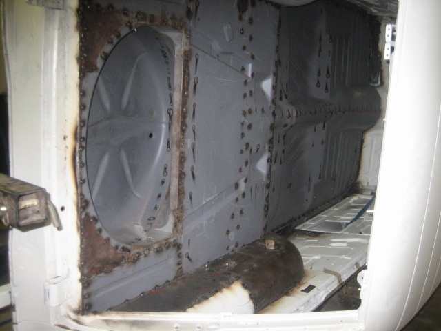

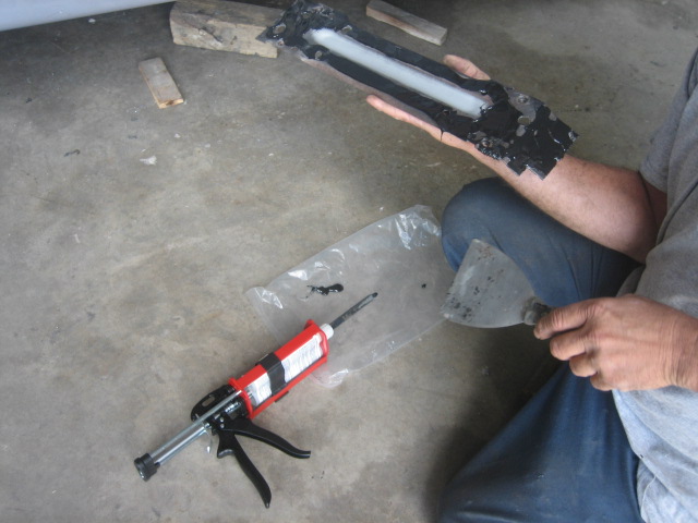

    We are replacing the bottom 10 inches of a 55 Nomad and there is going to be about fifteen hundred spotwelds when done. I know many use far fewer and cover the seams with some kind of pooky which I guess is okay but for every factory weld that is drilled out I want one put back. The rear cargo floor has 370 ( I counted ) and it isn't that big of an area. On the front seat floor reinforcement and the rear seat bracket we used panel bond and it looks like the way to go. Many times faster, no grinding and clean up, and no welding required. The metal must be clean and roughed up with 36 grit and held together tightly but the bond is stronger than weld. Chevy pickups have the door hinge bonded to the pillar and airplanes no longer use rivets so it's both strong and dependable. The panels end up smooth, not full of filled and ground weld spots. First pic shows the spotwelded cargo floor and second shows the bonded seat anchors (the short dark channel) with no grinding to do.
