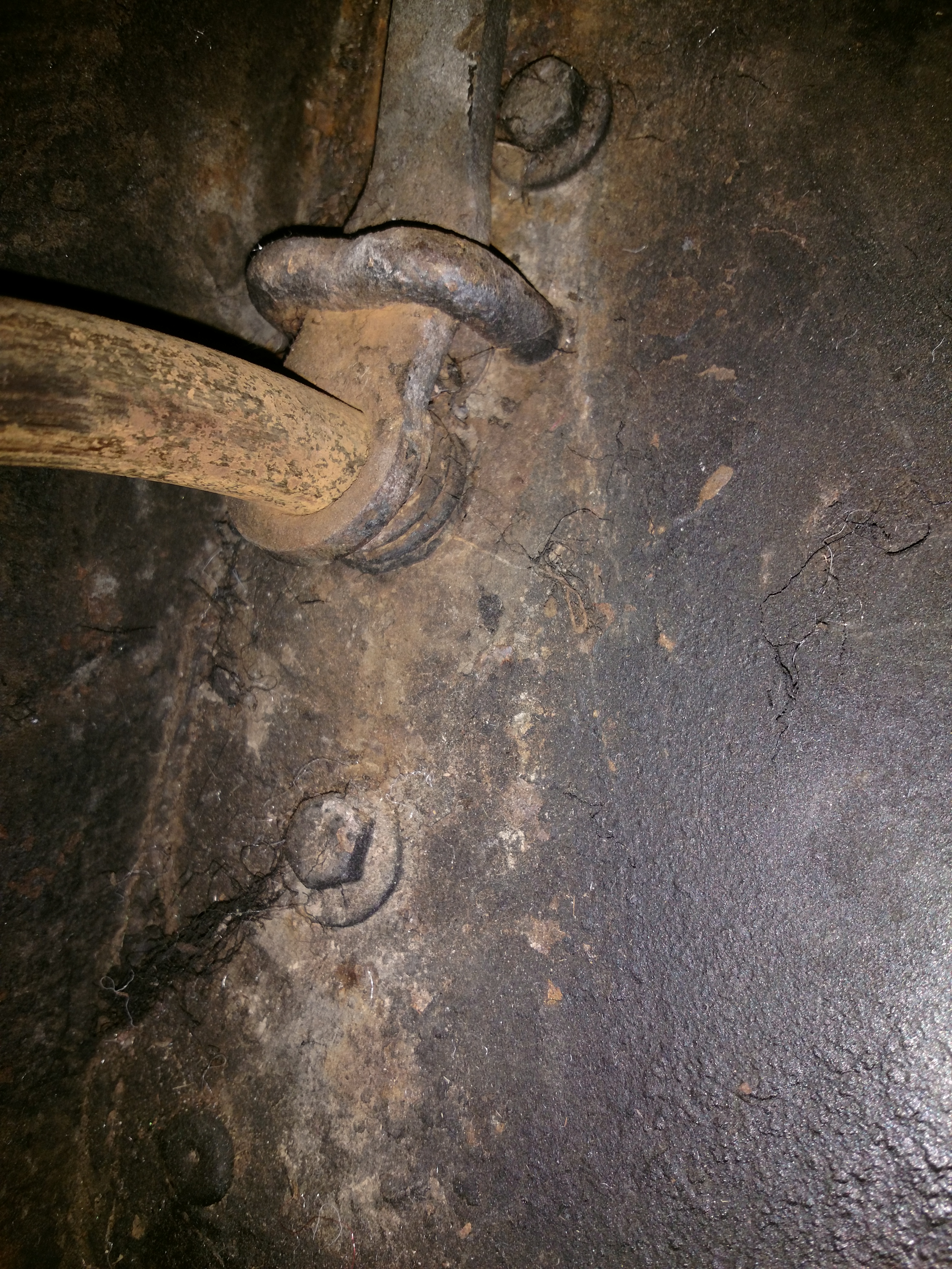

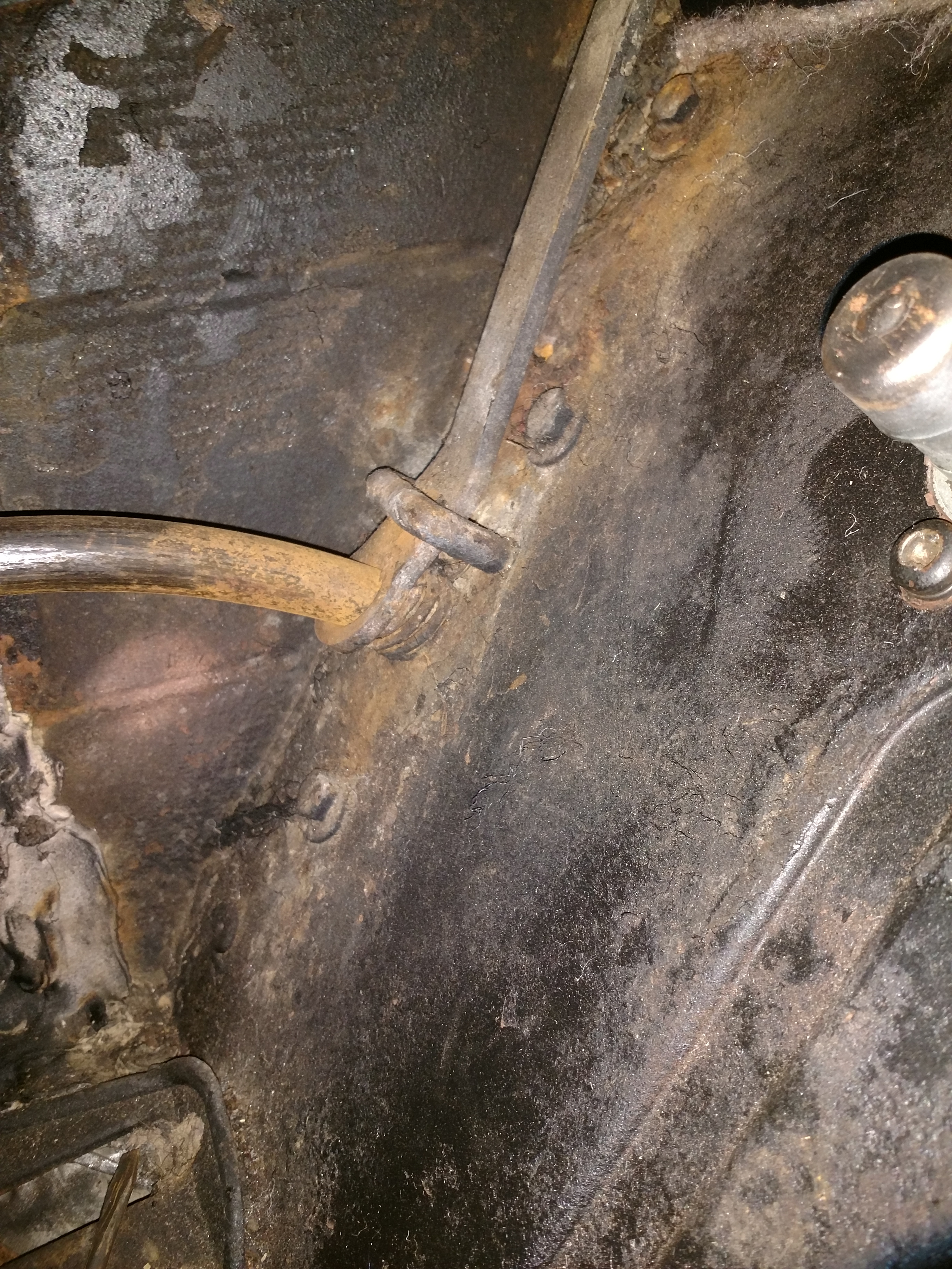

Hi all when I depress parking brake lever the pedal lock does not hold. I am thinking the spring below the love bar may be the culprit? Opinions? Thanks in advance . Assuming that is what I need, any suggestions where to get one? Our host does not sell it . Denis

All the spring does is position the locking plate so the pedal's shaft binds on it . I'm not there to see but I wonder how much cleaning you've done, I never trusted these in the 1960's but I also never had one slip, even on amazingly high mileage trucks .

Need pictures or images to discern what it takes to disassemble . I dimly recall the curverd shaft has a 3/8" bolt holding it to the park brake lever..... Any time you're working underneath the rig, it needs to be securely chocked (wheel on the ground) or braced (wheels off the ground or removed) else you risk DYING . Maybe look at the old thread sticky at the top of this page, Russ (?) built an AD from scratch and there's little he didn't document .
There is a 9/16 nut and bolt on engine side of fire wall. My issue is getting enough room / leverage to lossen. I will take pictures tomorrow

Well, I cleaned it up and replaced the spring and no change. Nate, are you suggesting bending the bar a bit more? What doesn't make sense to me is it worked fine since I have owned it and suddenly this year it stopped. Now if that flat bar is the only thing that holds the parking braking in place that makes some sense.
This really is a head scratcher ~ Before making any further changes I'd remove the curved round bar and flat locking plate pieces and test fit them off the vehicle to see what angle is needed to cause them to jamb up and 'lock' . It may well simply be the edge of the opening is worn and needs either to be dressed or replaced . I know this is a lot of work with no gaurantee of success but this is an important safety item .
No ~ go back and look at the photo in post # 1 : there's a round curved rod that goes through a flat bar with a hole in the bottom of it, take those two parts off the truck and see what's what . It's a simple friction brake so it should be fairly easy to figure out what's not working once you have the only two parts that matter in your hands .
