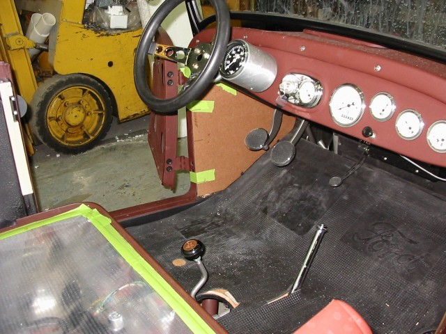

    On my truck I installed a hand operated floor mounted brake from Lokar. More on that at post # 21 here:https://talk.classicparts.com/showthread.php?t=13928&page=2
    Lokar also has a vertical style hand brake, I used on of those on my old Model T pickup. You have a couple options if you want to go aftermarket.
