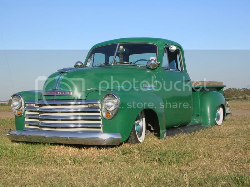

all you need is one pic, trying to get ideas on ride height, stance, wheels, paint etc. it does not have to be a album. one pic, lowered by blank, wheels are blank. simple
51 Fatman superlow M2 front end with 2" drop spindles and air bags, 215/75-15 Diamondback whitewalls, factory ford steel wheels, bullet lugs from Lugnut King, bullet center cones from King of Dice. IRS from 95 t bird, airbags, 235/75 15 diamondbacks. 53 buick headlight rings, 50s ford hood ornament. 350/350 combo, edelbrock 600 carb, performer cam, intake. Dempsey dumpster green paint applied by previous owner, pinstriping and EVERYTHING else by current owner.
Praise The Lowered....... Ha ! betcha didn't think you'd ever hear me say that didja ? All in all , it's a very good job there .
Don't Hold Yer Breath ! Low is O.K. , not for me . Besides , you have WAYY too many cylinders under the hood ! O.K. , maybe only two too many but they're lined up wrongly too
