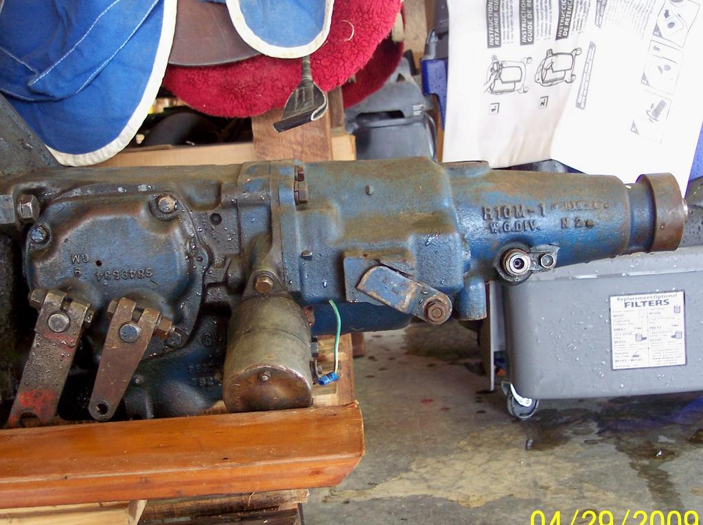

    Ken helped by running the numbers. It seems to be from a 64-66 Chevelle, 3 speed with a Borg Warner OD. Can anyone tell me what manufacterer and model this is. I want to buy a shifter for it. It has a 4 bolt side cover.
    #3849534 9GM, W.D. Div RIOM-1 B-15-4 N@
    Thanks,
    Flashlight
  2. Kens 50 PU
    Just to the left of the solenoid in both pictures is a set of numbers on the tranny itself. Post those numbers and let's see what that will do toward ID'ing it.

  4. coilover
    coilover Member
    Mar 30, 2005
    2,564
    Plano US
