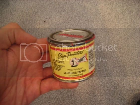

    here's the stuff you need to begin with-
    paint- i use one shot

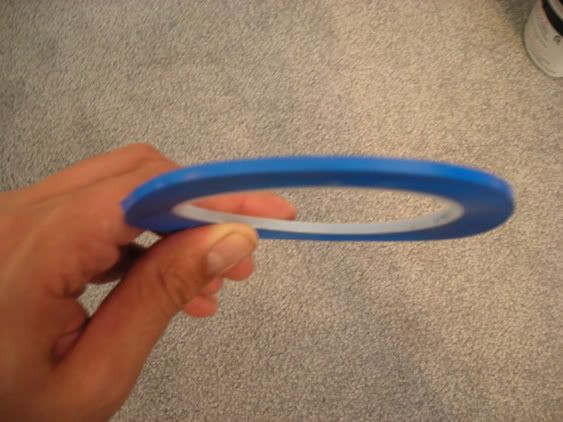

    3m fineline tape 1/8"
    tack cloth
    wax and grease remover (or you can use comet cleanser)

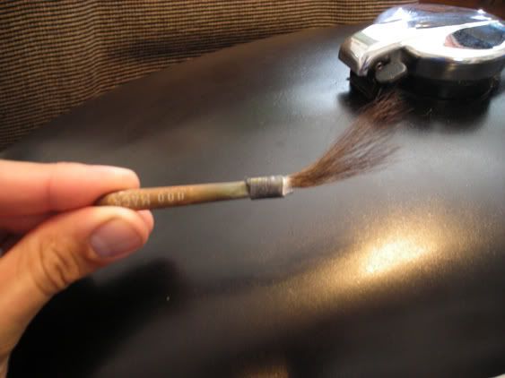

    ...and, brushes- lettering quill and sword stripers the quill is used for the thick lines and the striper for a thin line.

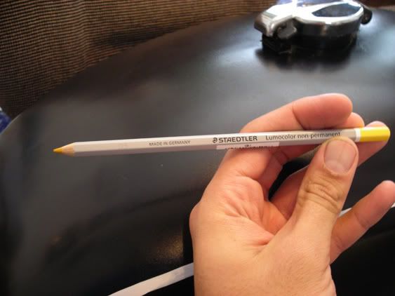

    although i'm not using it this time, my stabilo pencil is invaluable for drawing in center lines when doing designs or lettering. it's water soluable, so you can wipe it off after the paint has dried.

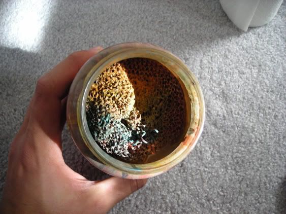

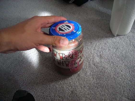

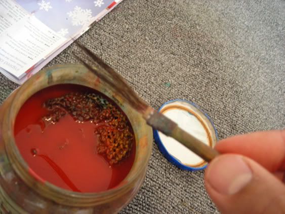

    *here's a little trick - take an old pickle jar, and stuff two of those cheapo plastic scrubbies from the kitchen in there, then fill with mineral spirits. when you clean your brushes, you can use the scrubbies to pull the paint off and the dregs will sink to the bottom, leaving fresh thinner at the top for you!! -- also works well for fine arts oil paints- you artists out there!!

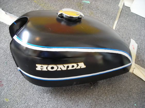

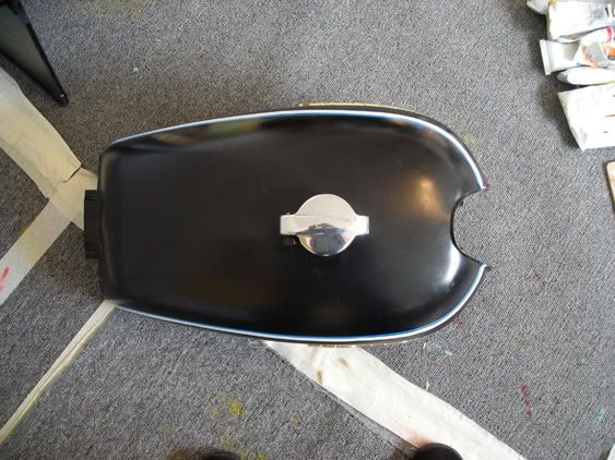

    alright, after i cleaned the carpet for about 30 minutes, and my girlfriend stopped yelling at me, i moved back into the studio and got painting!! yeah!!

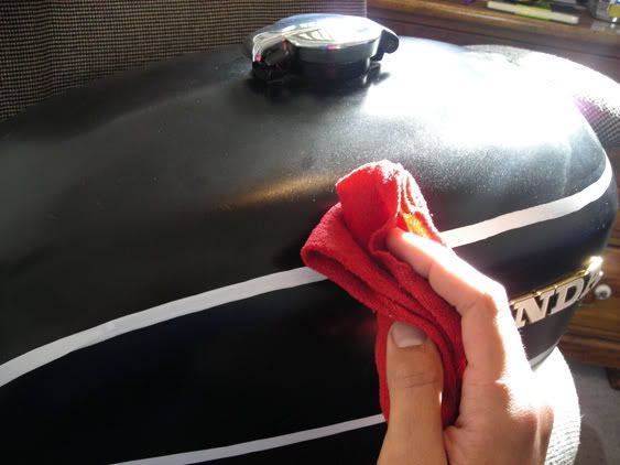

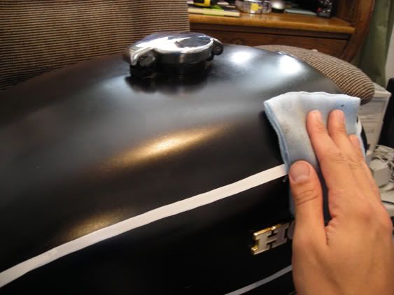

    this is what i started with. the blue is the fine line tape i used as a guide to keep both sides looking the same, and i made sure to keep it symmetrical from a top view.

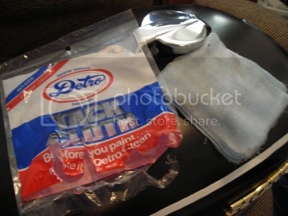

    i wiped it down with the tack cloth, to remove dust and dirt, then the wax remover, so the paint will stick right to the tank, and not get fish eyes (bubbles), then one more time with the tack cloth because the rag i used for the wax remover left some lint. don't want that in the paint!!

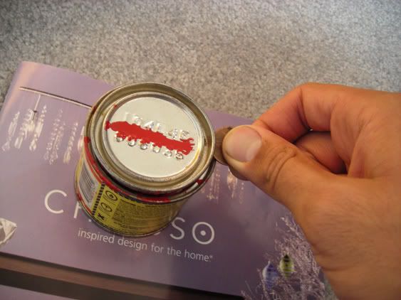

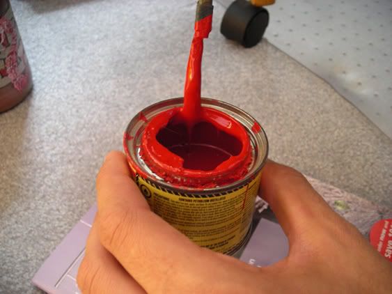

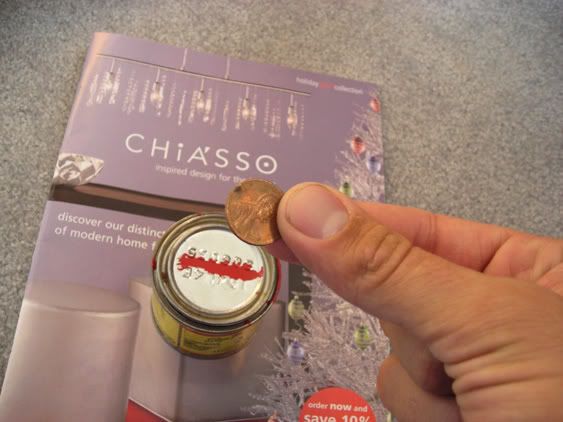

    now i use the secret unobtanium can opener- a single red cent.
    grab some paint- all the way to the hilt
    don't want drips, but keep as much paint on there as you can!!

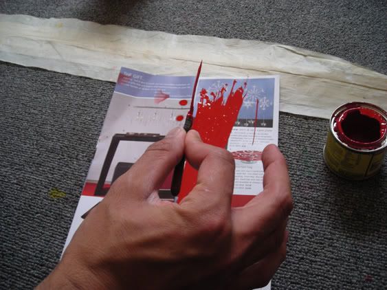

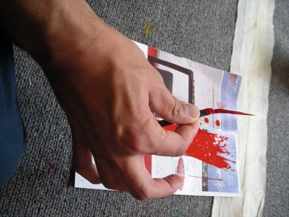

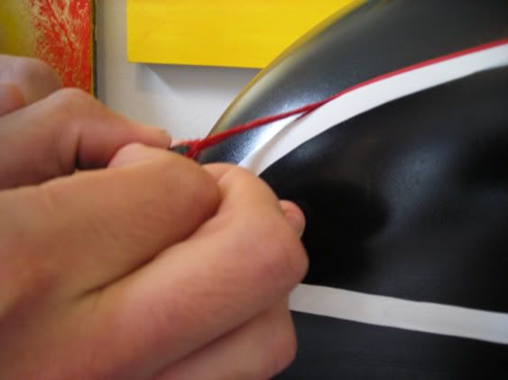

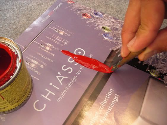

    here's the most important step- palleting your brush. wipe the paint on the magazine, keeping the brush in line with the page- you're looking to make the hairs nice and flat and get a feel for the consistancy of the paint. usually, the paint straight out of a brand new can is just about right!
    this is how to hold the brush. the little wooden part always goes to the left- even if you're left handed. this is so that the point of the brush is at the top and it allows a very thin line with little pressure, and a thick line when you smash the brush down on the tank.
    let's paint!!

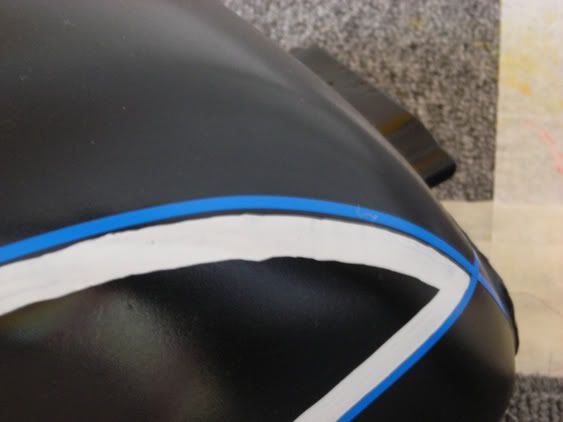

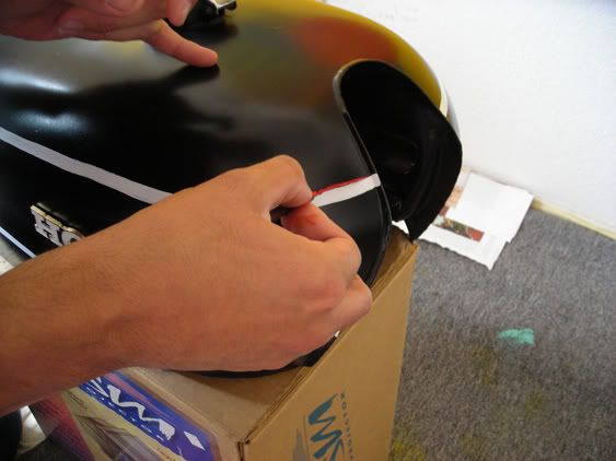

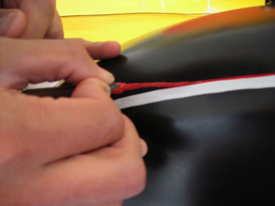

    here's some shots of laying the line down. sometimes you really have to be a contortionist to get the brush where it needs to be, but the paint still flows. it's amazing!!
    you'll notice here, i had to stop and load the brush up again- the secret is to make bold, long strokes with the brush and then pull it up sharply when you start to feel it drag more. then you get more paint, pallete it again, and start your line about 1/4 to 1/2" into the last line you laid down. if you're quick about it, the paint will flow into itself and when it dries, you'll never know you even lifted the brush!!
    [​IMG] [​IMG]
    keep on truckin'!!
    fast forward to the future...

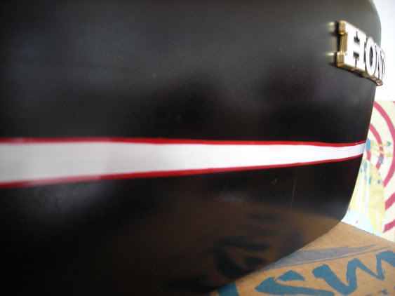

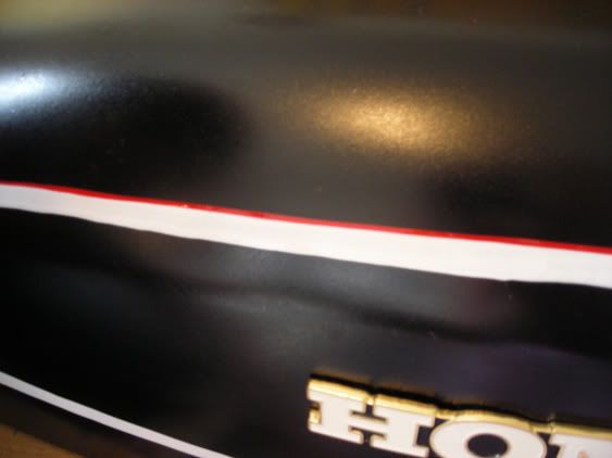

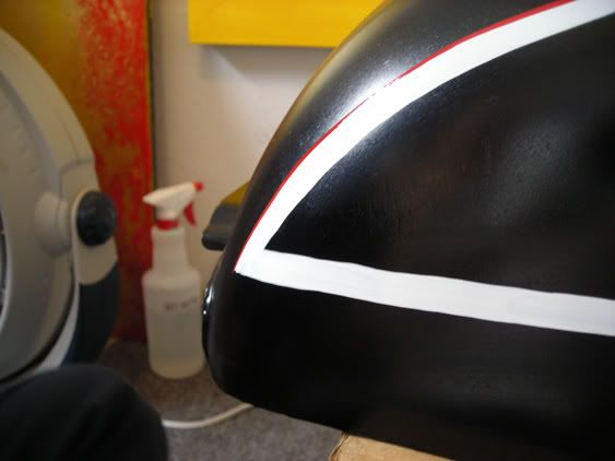

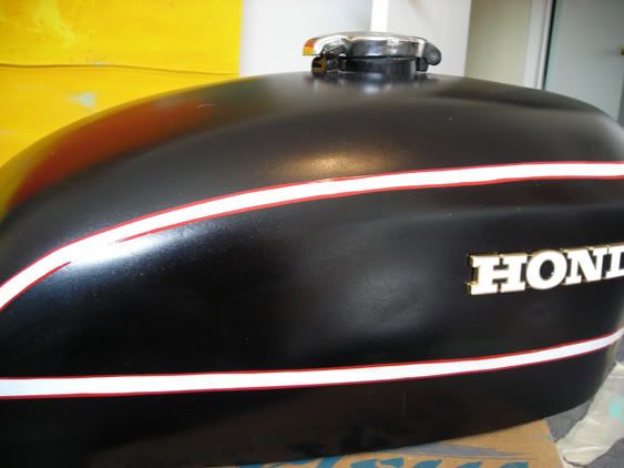

    viola!! it's done!! next, the most important step- cleaning your brushes.
    btw- store this in a cool, dust free environment for about 24 hrs until the paint can set up! then we'll tackle the other side!!

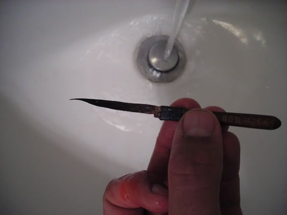

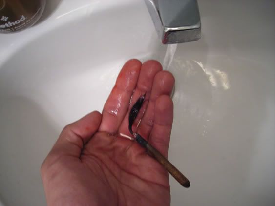

    now for the cleanup- the magazine pages fold in half- then when the paint is dry, you can rip them out and toss em. as for the brushes- they need to live on to paint another day!!
    first clean them in the thinner as best you can
    then i like to rinse out the caustic thinner with regular hand soap. just lather and rinse, then repeat!

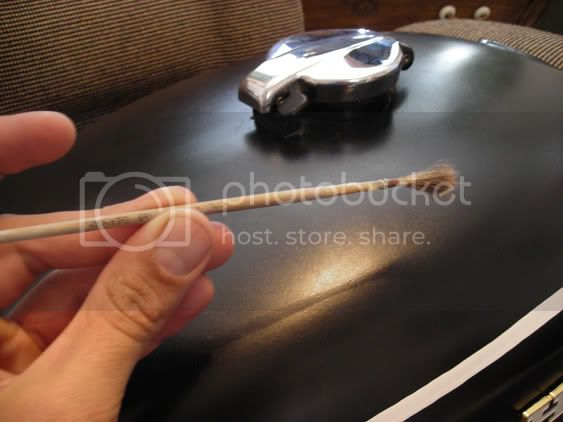

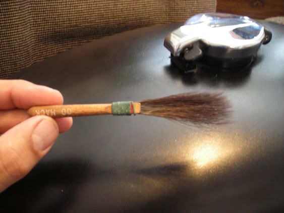

    here is a great picture of how the sword striper works. this is it's natural position. it should be stored in this way, and it should be paleted this way before you paint. the top hairs are longer than the bottom ones. this allows the paint to flow from the hilt of the brush all the way down to the tip. this is nice, because it allows you to paint those really really long lines down the side of a car! otherwise, you'd be getting more paint ALL THE TIME and that's no fun!
    some people store their brushes in motor oil, or linseed oil, or even ATF. if you do this, be sure to rinse that stuff out before you stick it in the paint! ewww!!
