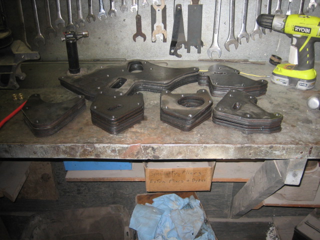

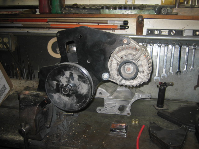

    Every supplier I buy from I WANT them to make a profit because if they don't they won't be around the next time I need their product. Lately it seems more and more that there is no correlation between value and price. We hardly ever put in 350 Chevy engines anymore; it seems everyone opts for the LS series engines and to compact the front accessories (a/c, p/s, alt.) one uses after market brackets. These brackets are being priced from $1000 to $2500 which really inflates the swap cost. If you are thinking about doing something like this get a forty dollar 2ft square of 1/4" steel plate and carry it to someone with a plasma table. Take along the bulky factory cast aluminum brackets for them to trace around and for about $50 they will cut new ones out for you. Total cost <> $90. We do them six at a time and use them up in a couple months.

    PS, How do you guys mount the AC compressor? The low mounting position does not look like it will work.

    A company called KWiK Performance Inc (www.kwikperf.com) manufactures brackets to relocate the A/C compressor on LS engines. They have different brackets for Corvette, F-Body/GTO and Truck accessory drives. I think this bracket may be what is included in an aftermarket A/C system (you need to specify what engine you have of course).
    The high/outboard relocation may interfere with the inner fender. I'll know pretty soon. Stay tuned!
