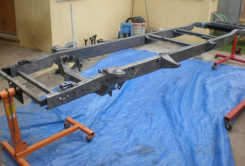

    Okay, let's give this a try one more time. Tried to post pics a few weeks ago, but they just wouldn't upload to the site. I believe it was my wonderful new ISP (Clear). They are no longer my friends, clearly :D
    Anyway, I'm almost done with the chassis, and I know I've said that before, but there is so much to it, right?:eek: Sorry bout the dusty frame. That's what is left from the months of sandblasting, and the maid didn't show up.

    Looks real good. A little dust can't hide all the hard work. Keep on messing with it and you will be driving it soon. Good luck and thanks for putting pictures on here for the rest of us to look at. Please keep us posted on your progress and more pics.

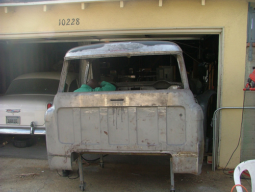

    Here you go
    It works great when you are painting it also.
    I made this dolly with wheels to roll the cab around. I made mine out of steel but you can just as easily do it with 2x4's. I bolted the cab to it with the cab mounts.

    The cab is not heavy at all. It only took a buddy and I to move it around. That was without glass or anything else just the cab only of course.

    Hey Bam,Did you notice in The Last Picture Of Your Cab, There Is a Guy Trying To Hide
    In Your Cab? lol. You Better Kick That Guy Out Of There So he Doesn't Become a
    Permanent Fixture, Or at Least make Him Clean or Sand Body panels!!!! lol....

    LOL. Oh that guy is doing a lot of sanding of the body panels.lol That guy is all on his own because friends seem to stop by and just take pics no help just pics.lol
