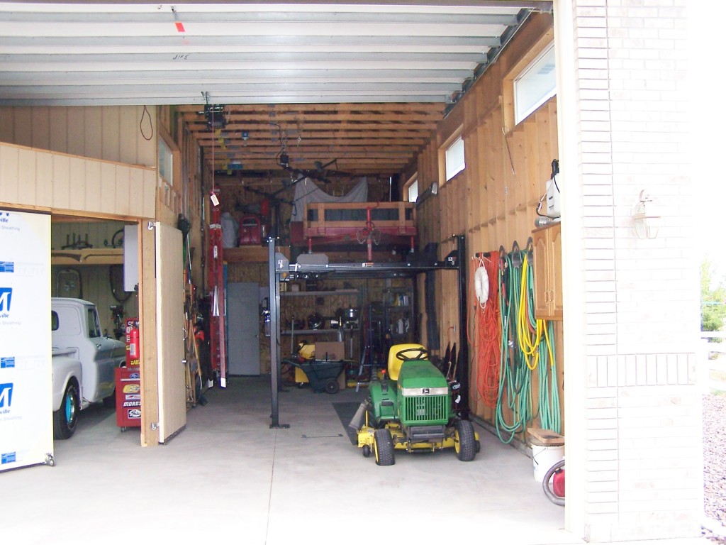

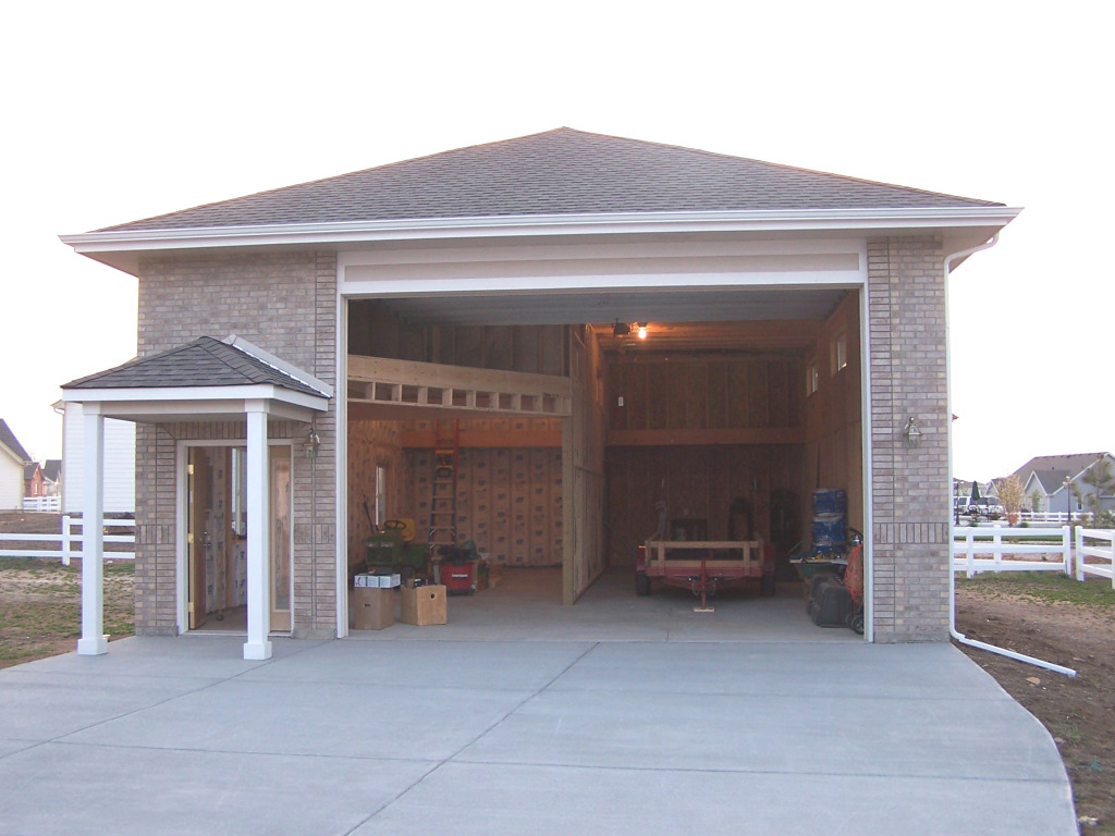

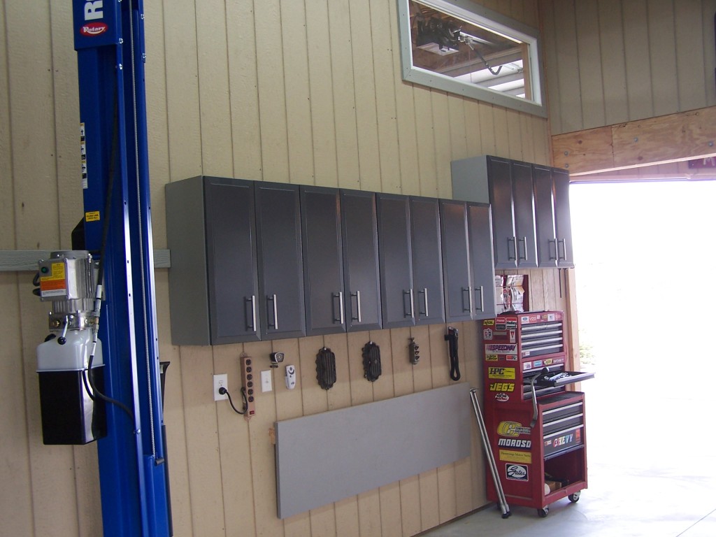

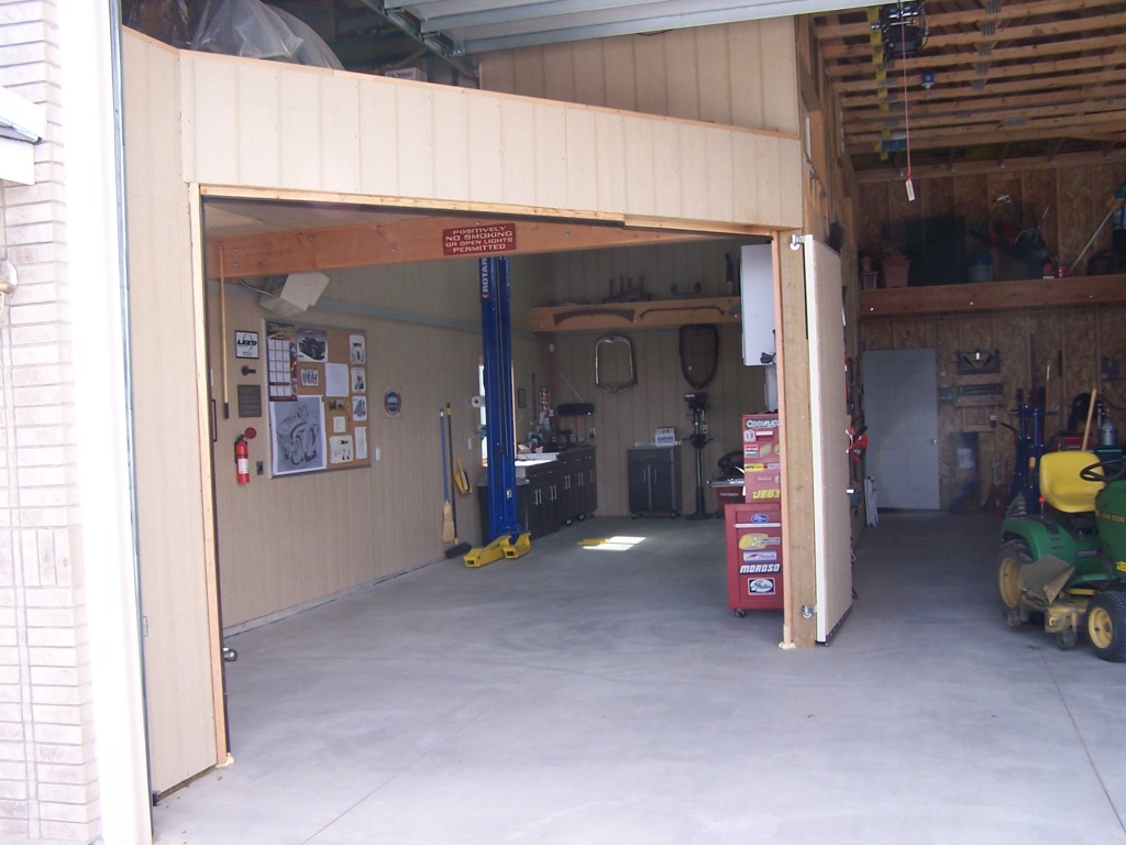

    Denisf,
    My shop is 30' x 40' with 14' side walls. I built a dividing wall down the center. The wall has a man door towards the rear and large doors in the front that are hinged to allow vehicle access. The left side of the shop is fully insulated. The right side is used for storage. I built storage lofts at the far end of each bay and a large loft with a pull down acces ladder at the front of the left bay.
    I made the countertop along side the 2 post lift hinged so I could let it down while working on vehicles on the lift.
    I'd be glad to answer any questions you have. And thanks to Martinius for the kind words! :)

  12. Zig
    Ehh-Hemmm, Flat tire on the John Deer? ??
  13. Lakeroadster
    Lakeroadster Member
    Jan 23, 2011
    1,599
    Central Colorado
    :D Got Air Compressor? Yep :rolleyes:
