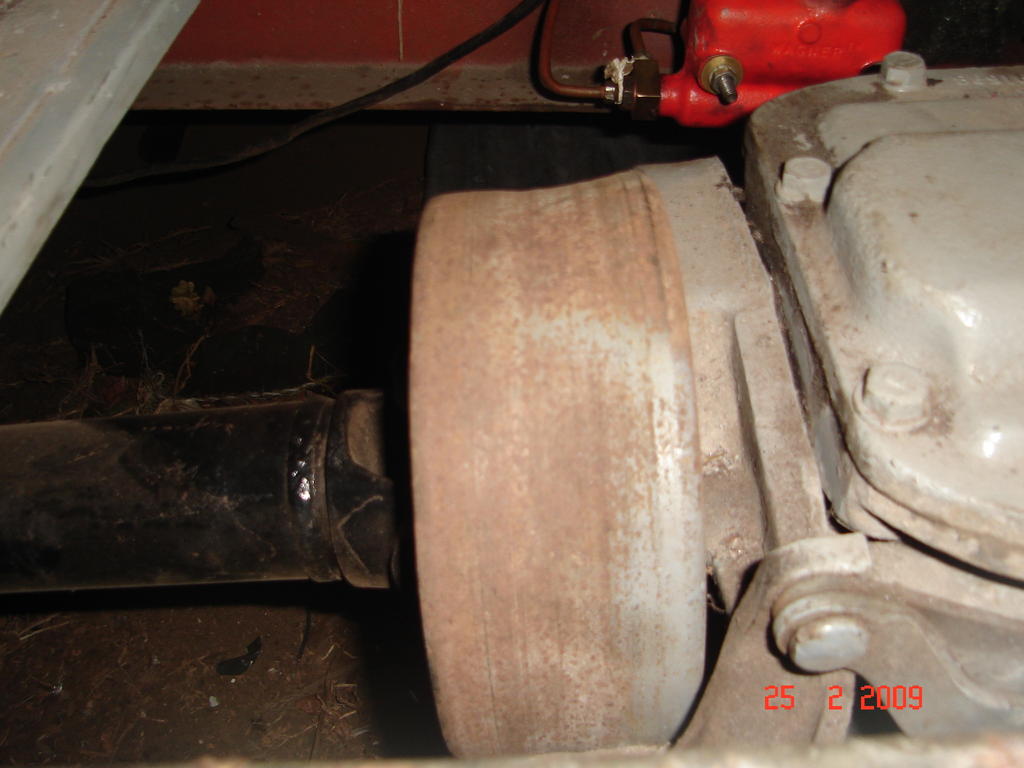

    Hi guys, does any body know where I can find this drum in good condition?
    thanks

    Looks worn from years of use. Not sure though as I don't have that type of brake in my truck. Bigger bolt guys have to chime in on this one.

    They ran it down to the rivets but that's O.K. as it's just a parking brake and NOT an ' emergency brake ' as you'll discover if you ever try to stop a moving , loaded truck with it.... :eek:
    Most older brake jobbers or machine shops will have the lining and can re-line your old parkbrake band or exchange it .
    Remember to pay close attantion to the spring loaded adjustment 180° away from the pinching clamp and adjust it for equal clearance all the way around the drum , failure to do so is the oprimary cause of drums worn like yours...
