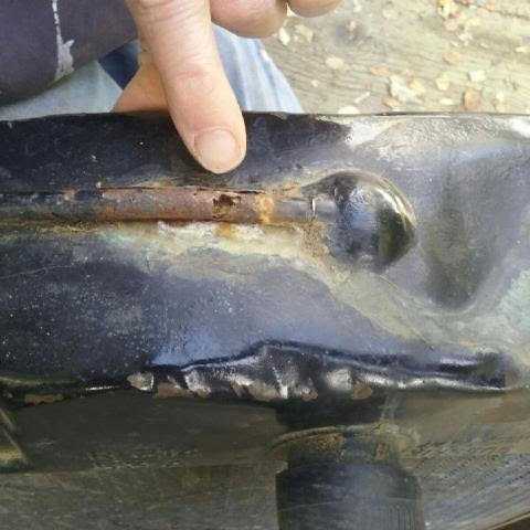

    I have a 51 3/4 ton with a radiator that is in good working order despite a few dents. The problem is that there is a hole in the overflow pipe now, which results in coolant leaking out. Can this pipe be replaced or fixed? I hate to buy a new radiator -
    Thanks for any help!

    Yes but ;
    You'll probably find when they drop the thing in the hot tank for cleaning that it begins to leak from myriad tiny holes as that looks pretty rusty .
    Me , I'd fix it and install a new three row core so I could forget about it forevermore .

    You can heat it with a propane torch till the solder melts and pull it out. We have a torch with a "fan" flame tip but you can just go back and forth with the torch and a steady pull on the tube till it turns loose. If it comes off in pieces your not out anything. Go back with a copper tube that won't rust but is more easily dented or pinched. By the looks of the top of your radiator this may be a concern. This won't help any heating problem but will keep over flow off the engine and away from the fan.

    Great, thanks a bunch guys. I'll try the propane torch trick to pull out the old tube and try to replace. I think that you may be right Nate, if the overflow tube is in that kind of shape I imagine the radiator itself may be developing pin hole leaks. I'll give it all a try before pulling out the checkbook for a 3 core new radiator!

    Remember ; once you've replace the overflow tube , you can use Cirtic Acid powder to easily clean the entire cooling system hospital clean .
