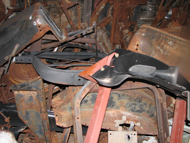

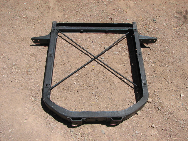

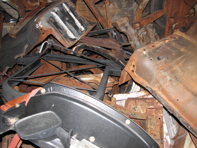

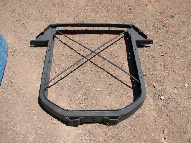

    We have a pile of good used supports.
    Shoot us a PM for more info.

    The question is: when I put in an aftermarket radiator the round rods that that form the cross bracing on the radiator support are in the way. Can I remove these and still have the support needed to keep the front end stable??
    The reason that this radiator doesnt fit is because it is sitting on an s-10 frame and I am lifting up the radiator enough to clear the power stearing ,now my drain pitcock hits one of the rods.

    Radiator Core Suport Cross Bars
    Yes , you can delete them but they do help keep things from flexing as you go down uneven roads .
