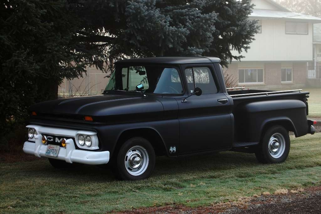

Rally caps I found a way to do it. I machined a jig to fit in the center hole of the wheel with a flange to the diameter that you need to hold on the rally cap. I brazed 4 pieces of 1/2" diameter bar about 3/4" long each to 4 places around the flange. This allowed the rally cap to snap on and stay. Here is a photo of the cap on the wheel. I think I am going to drill the 1/2" bars and drill and tap the wheels so they bolt on instead of brazing.
Rally caps These are photos of the jig and the lugs on the wheel. I welded these on. I made the jig out of an old Ford disc brake rotor I had.
Rally caps Thanks I had seen some of these on another truck but they had drilled holes in the caps and screwed them on. I knew there had to be another way to mount these caps.
Fantastic idea and a great finished result. That rim looks really unique with the slots and beauty ring in place.
