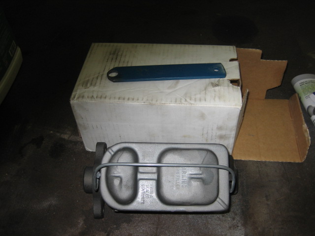

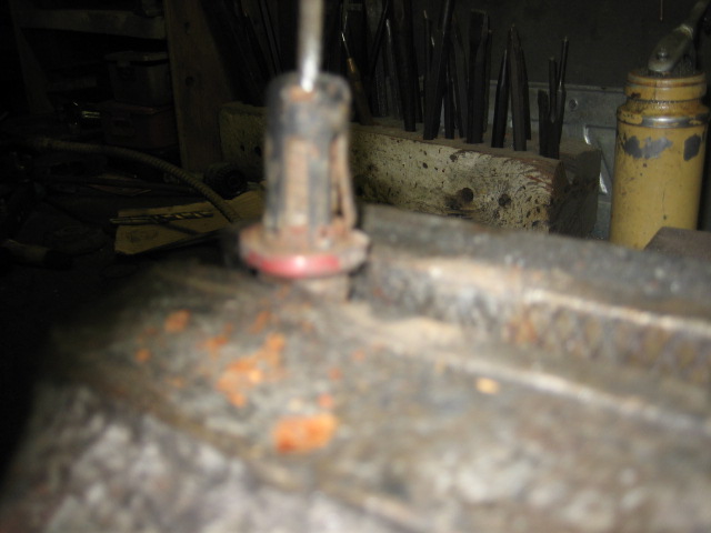

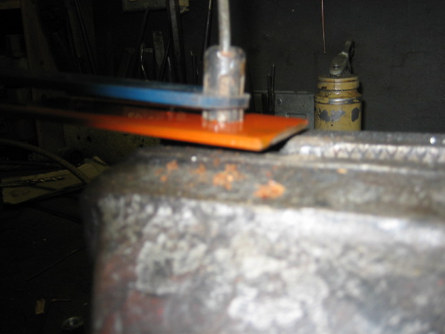

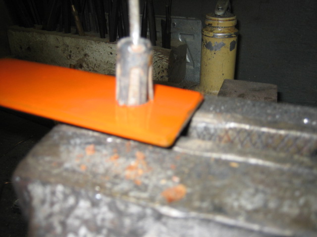

Okay, sure glad you didn't specify GOOD pictures. First pic is of the tool. Second is the E-brake housing with end clamped in vise and the prongs expanded. Third is the end snapped into an orange colored plate which is the same thickness as a backing plate, did this because the actual BP has a dip in it that wouldn't yield a good picture. Last is the tool not tapped all the way down but the prongs are already squeezed in. A tap on the end of the housing where the cable comes out will spit it right out.
