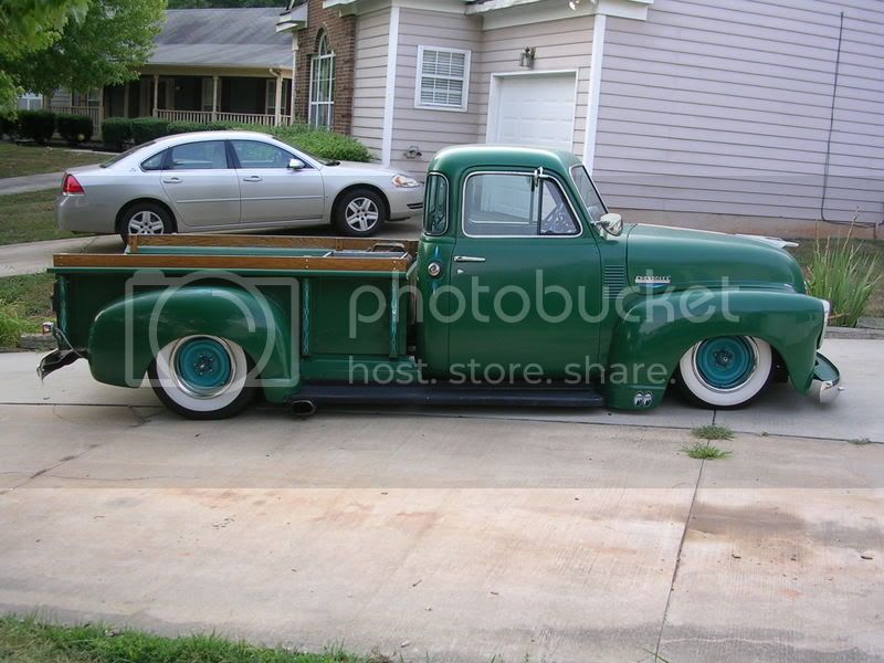

With that setup, why would you not notch it? Even if you aren't trying to ride it super low like mine, the notch will help ride quality by giving a litle extra travel. It is easy to install. You can make your own by splitting some 4" steel pipe, cutting out a half circle, and welding the c in. With a 4" c notch, the pumpkin in my truck would just hit the bottom of the bed.

nice. thanks for the reference. This is giving a great idea as to where i need to be ________ Medical Marijuana Strains
those are nice and help greatly. i am building mine along with a friend building his, and he is worried about having a normal bed in the back with full depth. Did you have to raise the bed due to it being so low? I personally am fine with raising the bed, or notching the bed. This guy is not great with a "computator", so im trying to get him some ideas and visuals. ________ COSMO
Not raising the bed was actually the reason I started looking at the IRS in the first place. I use my bed and didn't want to loose the depth.
