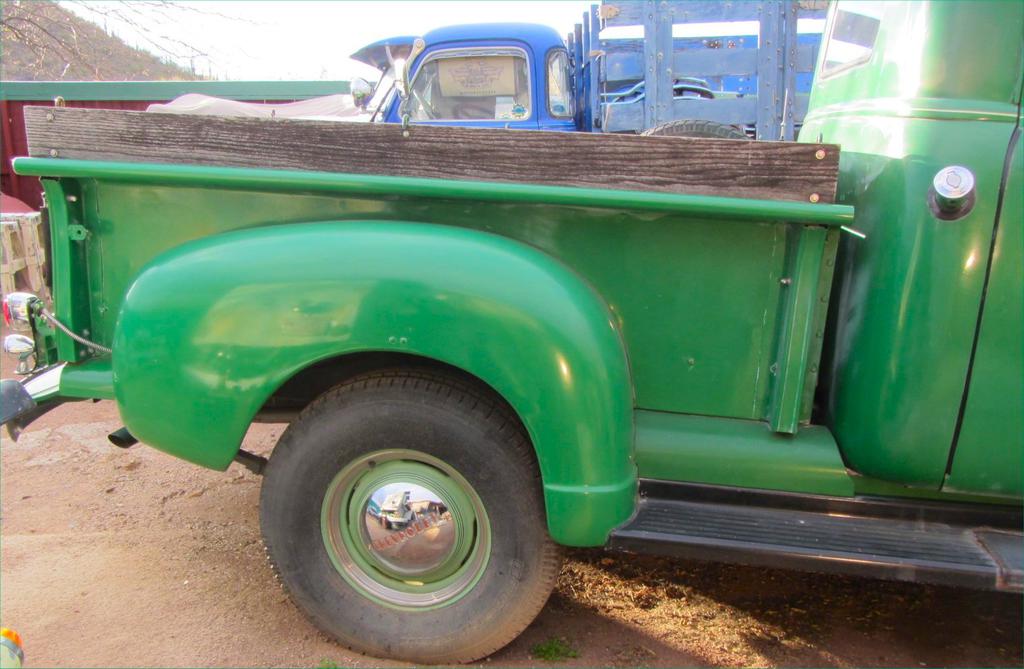

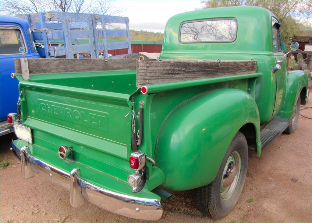

    I just got a new rear splash apron the other day. Looks pretty easy to install, but was wondering if anyone has pictures of there's installed. Also a pic of how it looks on the sides of the truck.

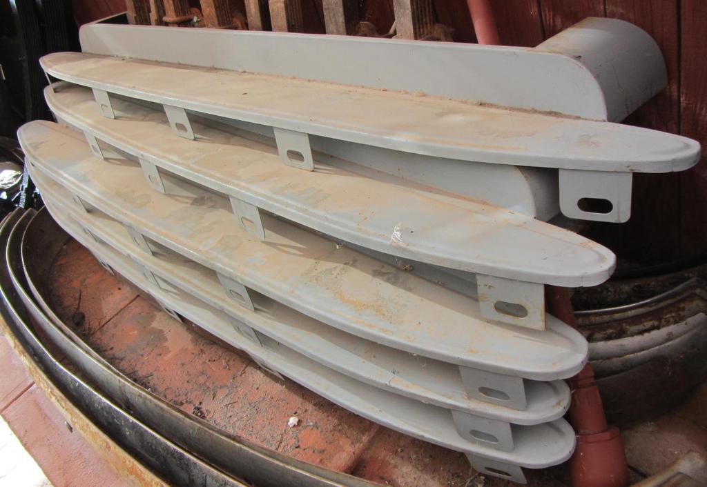

    How close should the apron side pieces get to the rear fenders?

    They are designed for 1/16"- 1/8" of clearance where the wrap arounds meet the fenders.
    I found that it is much easier to install by clamping it & using self tapping sheet metal screws.
    Screw the upper lip of the apron to the lower lip of the bed cross sill.
    Pre-drill the apron so the only thing the self tapping screws have to go through is the cross sill.

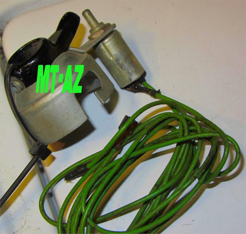

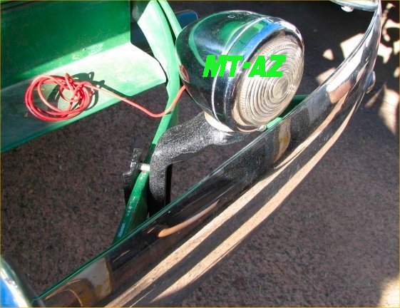

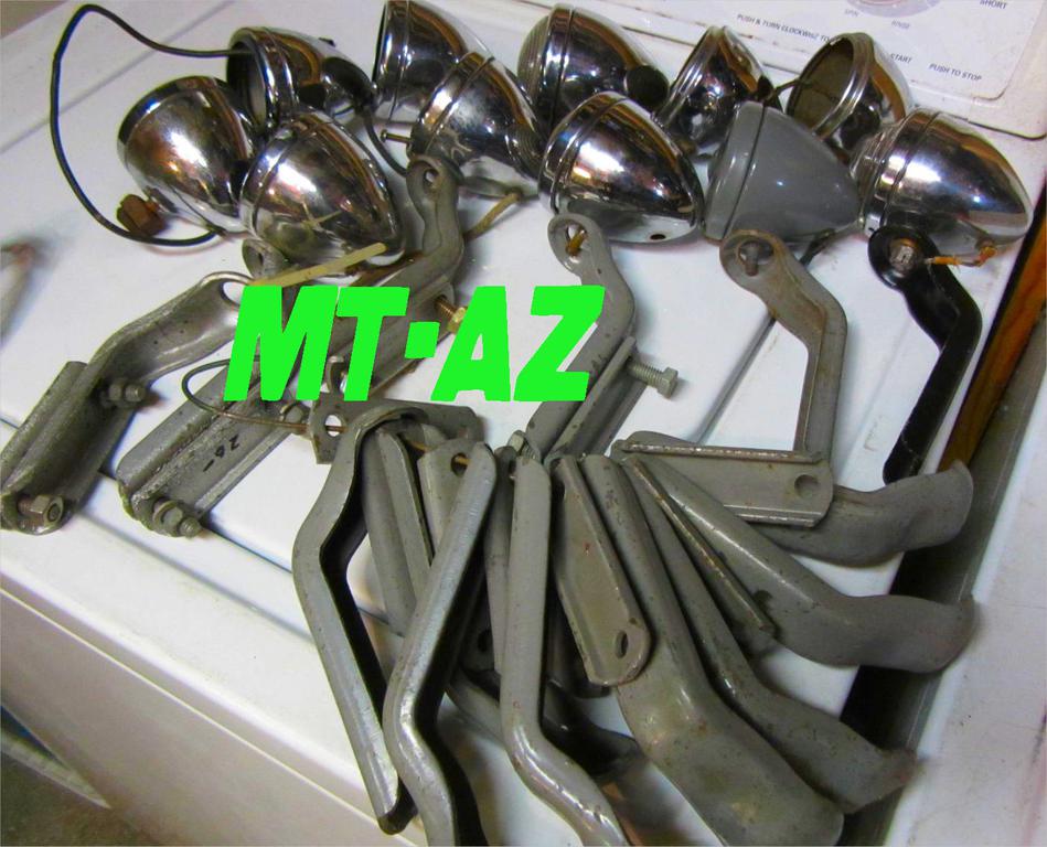

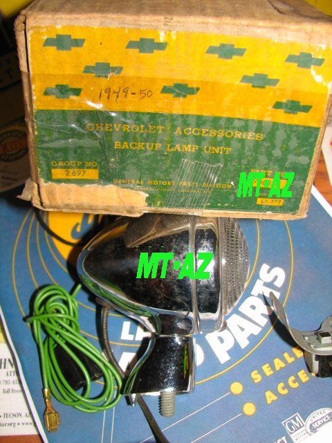

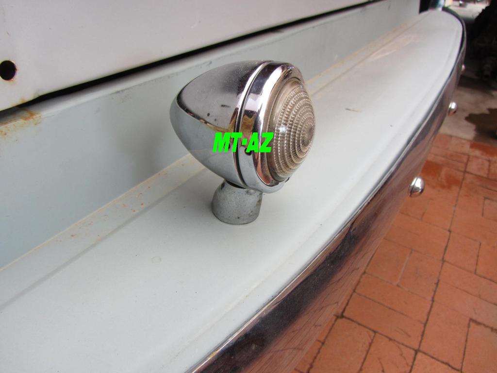

    Joe, I love the backup light on the green truck! Is that a Guide 2" teardrop? What about the bracket? What kind of switch did you use to activate it when in reverse?
  15. DeadZoneTruckin
    DeadZoneTruckin Member
    Apr 17, 2010
    628
    Yes it is the standard Guide lamp.
    Normally mounted with the Guide clamp to the bumper bracket.
    Installation on the splash apron would require the use of the stanchion mounted lamp.
    Switch is normally a toggle switch on the dash.
    If you really want to get fancy you can adapt a brake light switch to the 3 on the tree shifting linkages.
    Switch for the 4 speed trans. actually mounts on the shifter & a plunger switch activates the switch.
    If there is any interest in them I can put together a few units for anyone that wants one.
