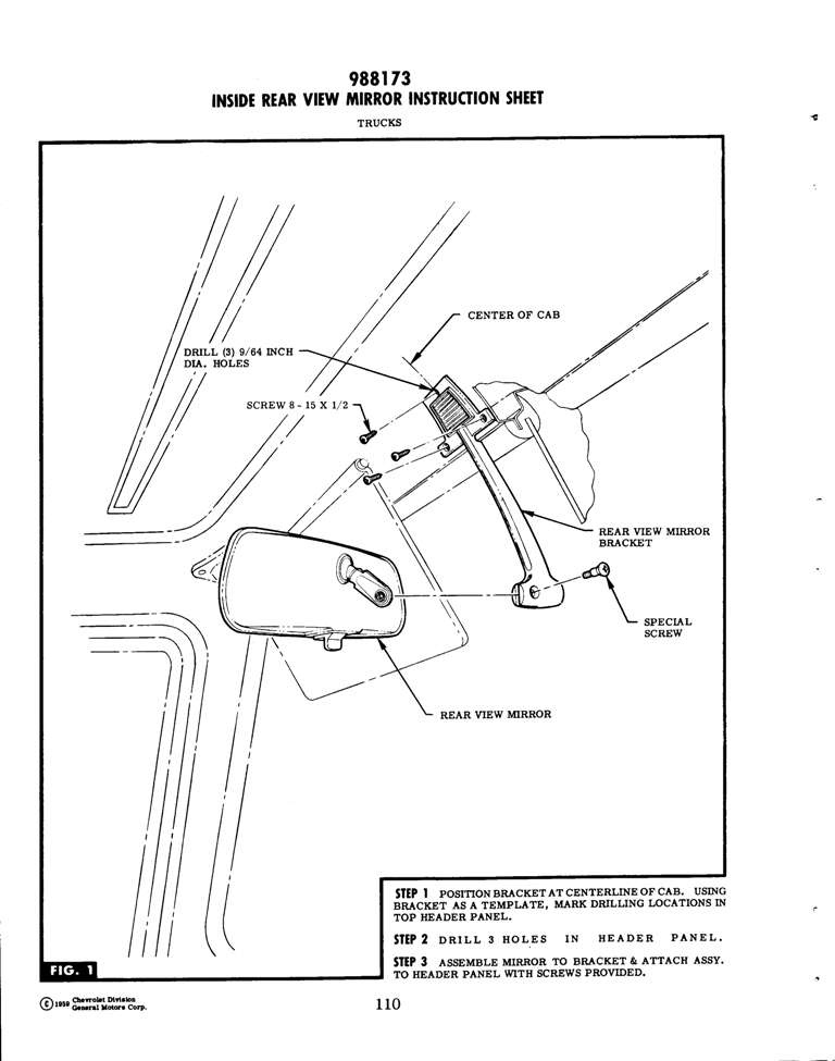

    wondering if someone can tell me the factory location of the mirror bracket on a 65 c10.
    the measurement from the top of the windshield rubber too the bottom mount screws would be nice, thanks

    Perhaps the factory accessory installation page from 1960 will be of some help. I assume it is the same through 1966. Unfortunately there are no dimensions included.
