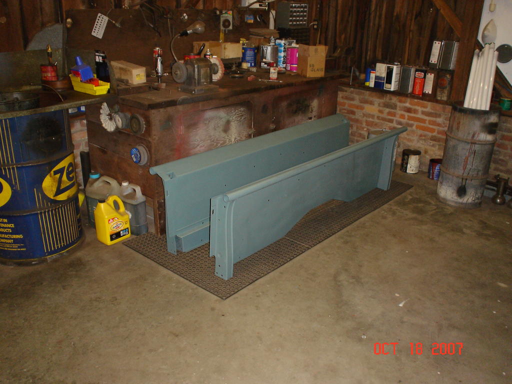

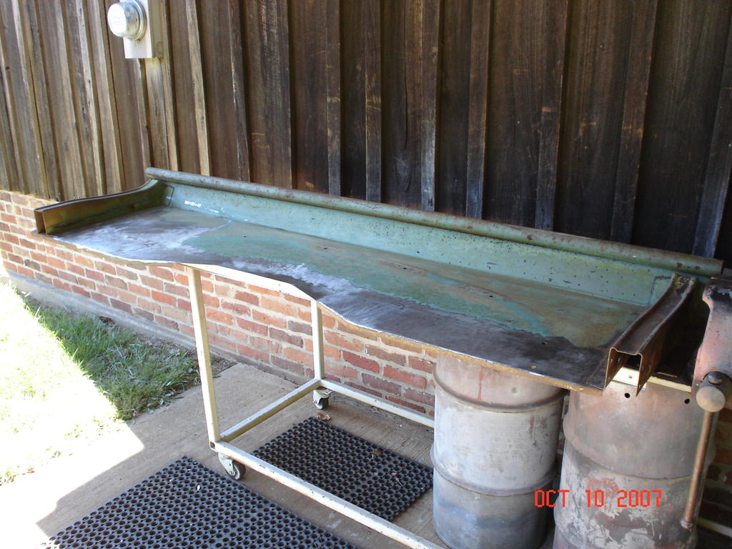

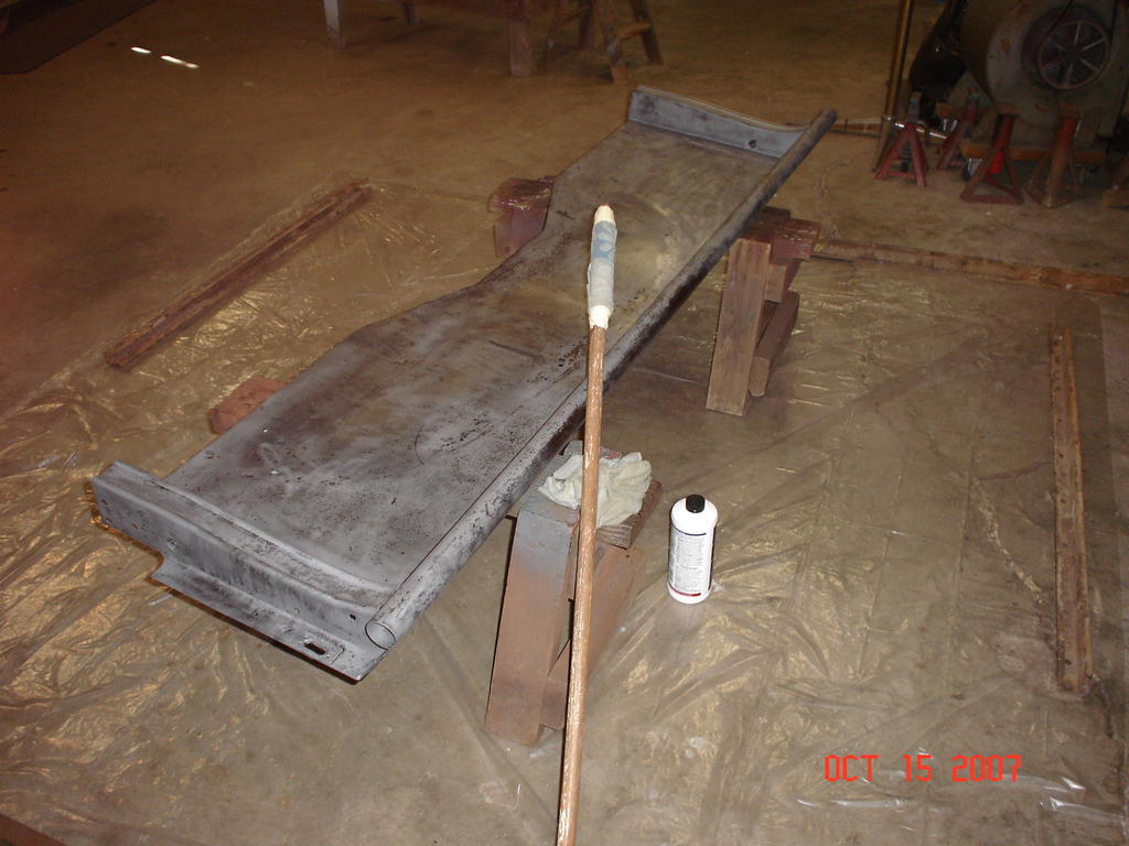

    Someone asked me the other day about how you protect your vehicle against rust in the hard to reach areas. I told them that they need to improvise. A good example is the inside of the bedrails on an AD truck. You can't reach all of it with a sandblaster, you can't take a 3M paint stripper to it. How do you inhibit the rust and keep it from bleeding down the bed 2 years after you've painted your truck? You do what this redneck did. You build a tool!
    I took an old mop, broom, whatever handle and affixed an absorbant material to the end of it. Then I saturated the material with Jasco metal prep and ran it in and out until I got full coverage of the inside roll. Here's some before during and after shots.
    I feel good about the fact that this part of my truck will not cause my paint to bubble up from within in a couple of years.
