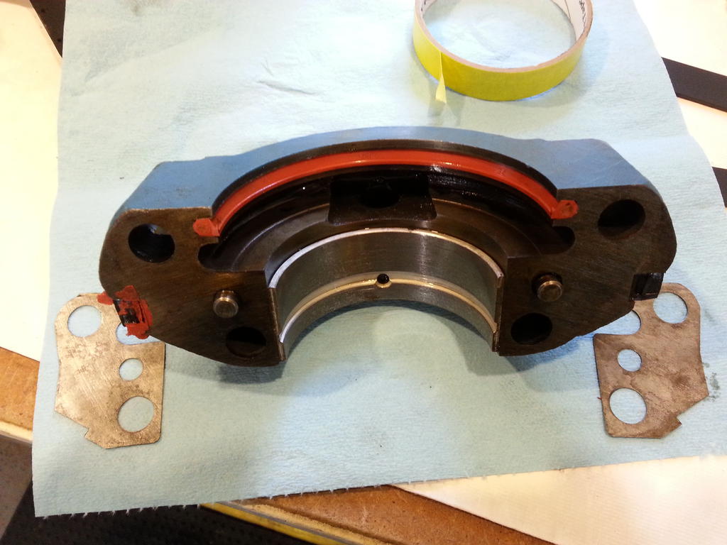

    OK Guys, I've looked at the thread on replacing the 'rope packing' type of seal, and as it happens, I've helped my Dad do one long ago.... I expected to do the same to my truck... NOT SO! My 1955 Chevy engine has a neoprene seal. I need advice on how to change in place. Pictures of my rear main will be included. On another note, I found that my truck has shims under all the main bearing caps? Normal? or Not? Do I need to plastigage them, or since I've already driven over 600 miles and don't see any wear on the rear main bearing, just don't question the shims? The shims cover the ends of the seal, too. Nate, When you're done with your PT, I'm sure you'll have some good advice, along with several others here. Thanks for the help.

    Seriously, I need some input on this please :confused: Can I replace this type of seal in place? This type of seal has a steel core, so do I drive it out part way and pull the rest of the way? Once out, can I slide the new one in and expect it to work OK?

    Thanks Damon. I read the article, and picked up some useful information. Interesting that the mech. stated that for engines using shimmed main caps, he wouldn't even think of using the silicone seal... Mine has shimmed main caps. Mine is also machined for the silicone seal, not the rope type??
    I may be fighting an uphill battle here...

    The shims are *very* important ! do not swap therm side to side .
    To remove that old seal , determine the exact center of the steel rod within it then use a slightly larger punch to drive it out , it'l stick a bit before beginning to move .
    Once it moves you can grab the protrusion with pliers and rotate the crankshaft as you pull it out .
    I suggest loosening all the main bearing caps to lower the crank a bit , most don't bother .
    It doesn't look old enough to leak , I wonder if the visible overage of red RTV is where it was leaking from ? .
    Rope seals tend to weep a bit in any case , I'd prolly give the neoprene typ a go unless there's reasons to think it won't work well .

    Thanks Nate. Hope you had fun with the race cars! The red RTV was introduced after the mains were torqued, when I installed the oil pan...
    The seal came out quite easily this afternoon. Hope that's not an indication of poor fit. I don't think a rope seal would be possible in this application as the groove is much smaller than for a rope packing type.
    I'm keeping the shims with their respective side. Out of curiosity, I plasti-gauged the rear main this afternoon, and found it to have .002 clearance. Exactly what the book calls for, (with shims in place). I've mentioned before that this engine had been overhauled about 12 yrs ago, and only run a few times since then, until I bought it. I'm hoping the long set up time caused the seal to fail, and a new one will do just fine. I checked the main bearing and it's .010 under. The pistons are clearly new as well as the camshaft, to the best of my judgement. I appreciate your input Nate. Wish you continued improvement. :)

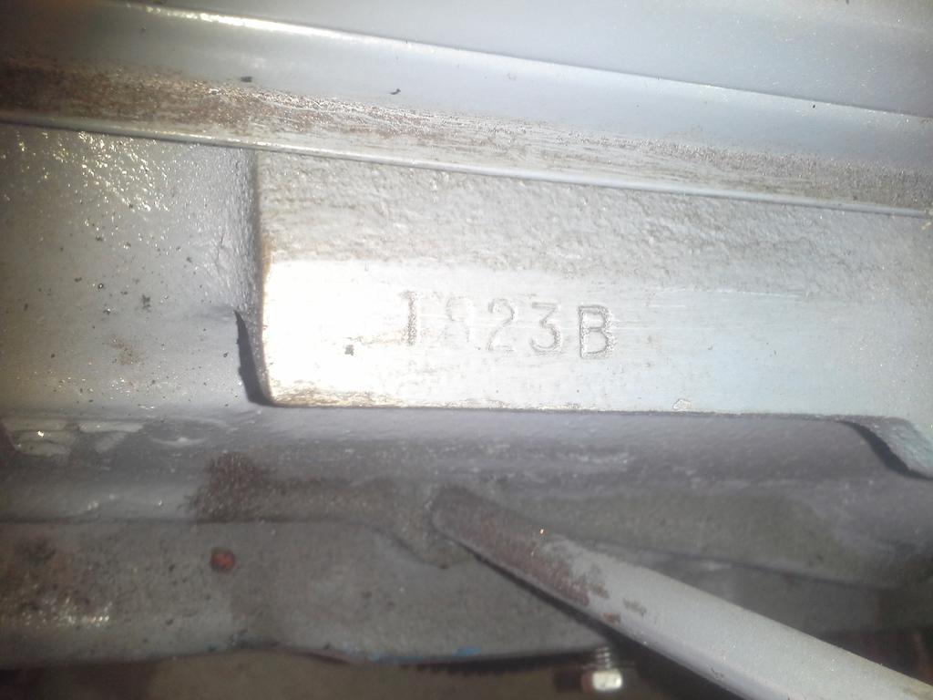

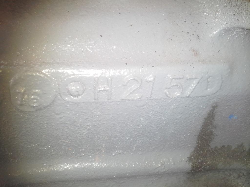

    shims
    Hope pics come out wanted to know what year engine was and if it had rear shims I have to replace rear seal

    821
    1957???
    i think the engine is 1957 car

    590
    Keokuk, Iowa
    August 21, 1957... I think. My '58 block only has the "8" from 1958 though.
    Damon
  19. Guest5979
    Guest5979 Guest
    Feb 18, 2007
    821
    thanks
