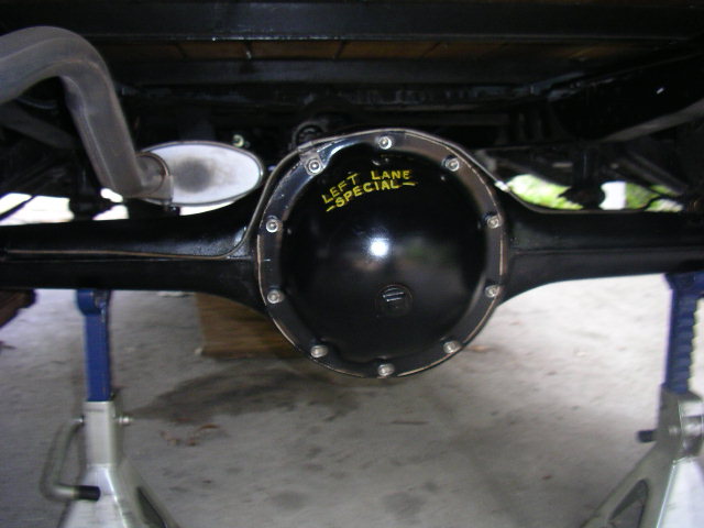

    I did the 355 gear switch on my 54 a couple of years ago with the help of one of my very good mechanical friends. it is straightforward, and very much worth the effort.
    Driving at 60-65 is effortless now with my 235 and 355 gears.
    Lots of support here and from Patrick.
