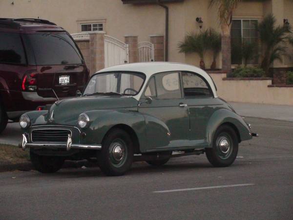

    The day before I left I bought this :

    A Morris Minor? I had a uncle of mine give me an engine out of one of those to tear-down and re-assemble as a high school shop project.
    When I was done, I wanted to put it in dads cub cadet.
  13. Zig
    Cool ride Nate! You sure you fit in that?

    Getting in is tricky but once inside it seems O.K. , we'll see .
