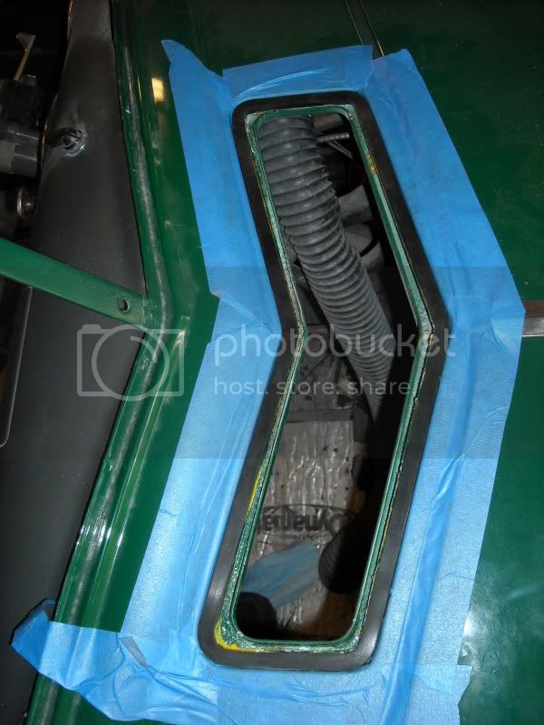

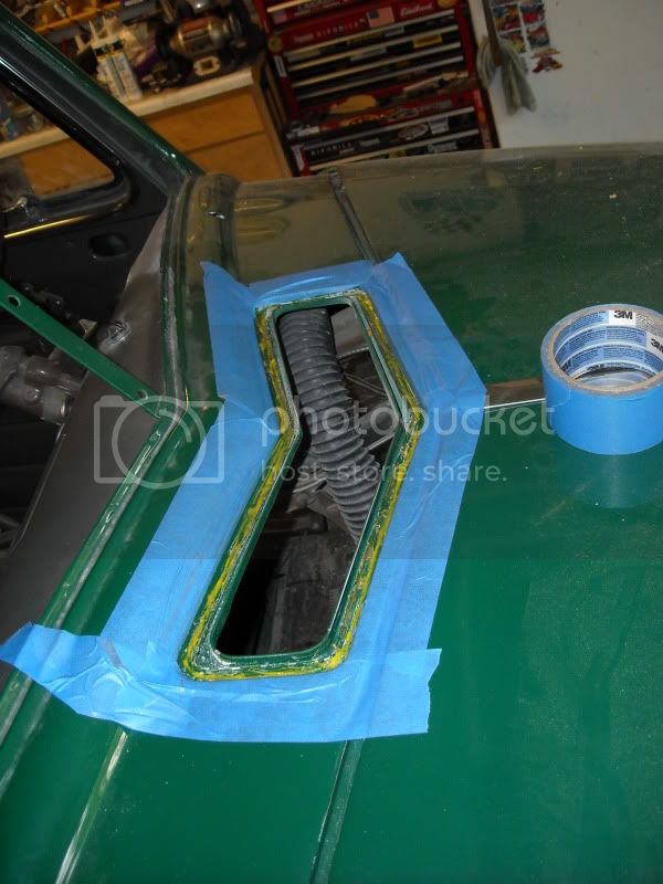

    Now for the cowl vent. Tape everything first.
    Clean off old glue. Now glue in the rubber seal. I found that it all fit nicely after trimming the rubber to fit just inside the vent when closed. Close vent down, then trim with a very sharp exacto knife.
