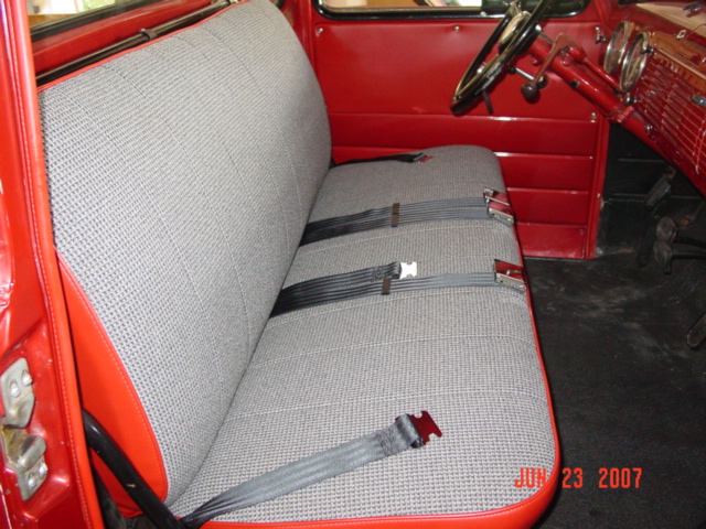

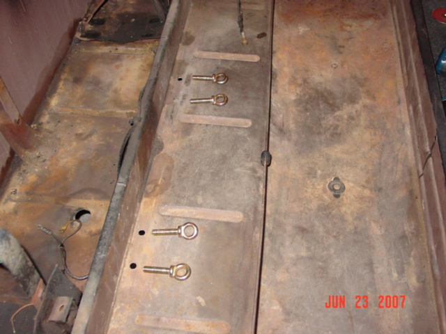

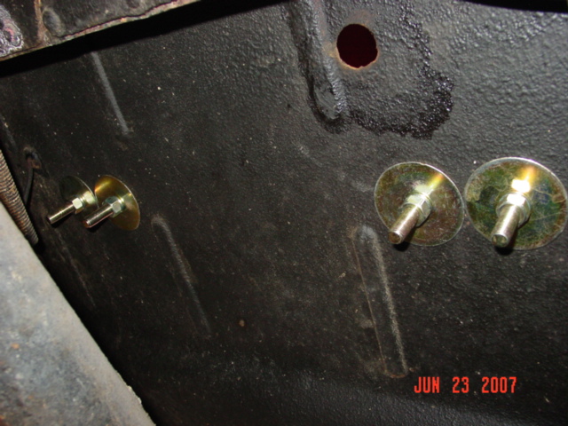

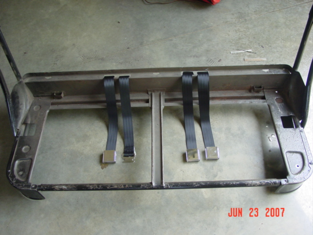

I installed lap belts in my 53 today. It was not too difficult a job. Biggest challenge was making sure the washers did not overlap and that I could get a washer and a nut on the ones over by the doors (thanks Nate for that advice in the archives). Here are a few pictures. I had some good help!
