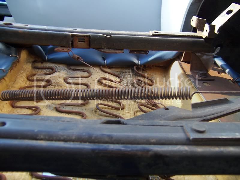

    I took my seat apart to recover it. It has a bracket that attaches to the seat. I can't remember how it goes together. Would someone upload a picture showing how all that goes together. This is on a standard seat on an 87 Silverado. I have a picture of the seat in the member gallery.

    Sorry no pictures, but your seat rides on whats called sliders or adjusters. Look for the one that has the handle, it mounts under the left (drivers) side. The right side slider is connected to the left via a long metal type wire. These sliders are spring assisted so watch the fingers.

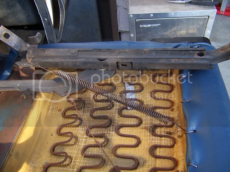

    Heres a shot of how the seat tracks go together if thats what you're referring too. This is a bucket seat but the only difference is the wire that goes across the seat is longer on a bench.

    Thanks for you picture of the slide bracket.
