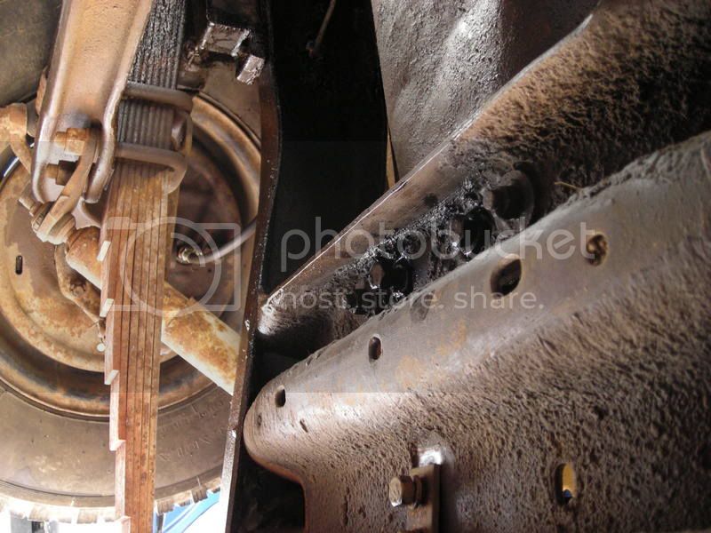

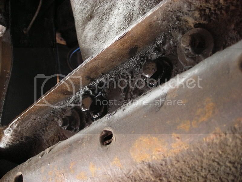

    -which are loose, and i'm not sure what they're for. i tried to tighten them, but they just turned and turned. also, they're covered in oil. probably another problem all together, but i thought i'd ask. help!! thanks,
    jon
  2. vwnate1
    11,675
    Looks Like
    Front motor mount bolts , you'd better slip your hand up over and feel for the other end turning so you can tighten them up , the one with the square washer in the very last pic appears to be moving over 3/4" and that's _very_ bad , can crack your crossmember....
