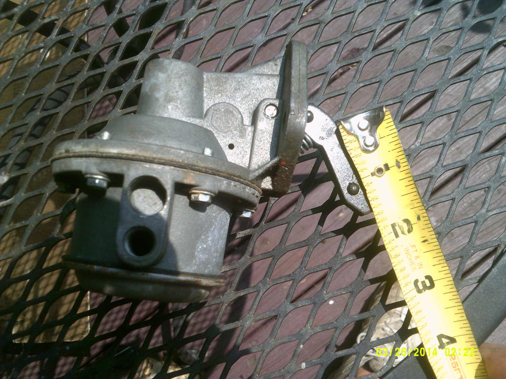

    Speaking of fuel~
    You said you had the old fuel pump laying around there that you rebuilt?
    Could you tell me if this looks about like what came out of yours?
    Thanks!
    The tape hides it, but the arm is straight. And no... I'm not fixing to grill it up.

  14. Bill Hanlon
    2,723
    Fredericksburg TX
    Mine said the same. Once I had everything else sorted I adjusted the octane selector to about half way from 0 to A and the vacuum went up to 18 inches. This made for a slight increase in performance, but is not a fix for your basic poor running.
    I won't be able to get to my spare fuel pump for a few days.
