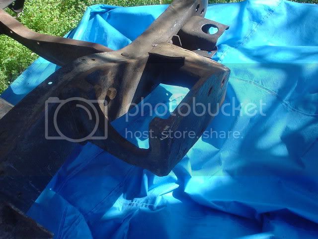

    Saw this about a year ago on a 4x4 forum I frequent, might give you some ideas.
    Frame off restore of a Blazer converted to RHD
    rest of the thread:
    http://coloradok5.com/forums/showthread.php?t=185001

    Nerfherder,
    Thanks for the reply. This definitely looks like a unique way of doing this conversion. I'd say that the frame has stopped cracking at the steering box because of the 3/8" (??) plate that this thing is mounted on. Mine is on a 22mm (7/8") plate to get the output shaft of the steering box in about the same position from the chassis rail as it originally is. I'm trying to "mirror image" the steering as best as possible to maintain the original steering geometry............along the lines of "if it ain't broke, don't fix it".
    Interesting post though. He actually shows photos of his ex truck ...........and ex girlfreind .........on a beach not very far from my place.
