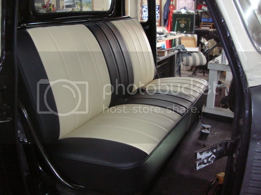

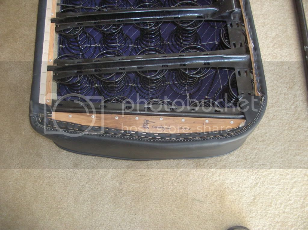

    Coach, here are a few pictures of my upholstered stock seat. The guy attached thin plywood around the perimiter of the fram in order to staple the cover to instead of hog ringing to the springs.
  8. Zig
    DANG!!! THAT IS NICE!!!
    Did you put anything under that rubber floor mat?
    Your interior is looking fantastic! Thanks for posting the pictures.

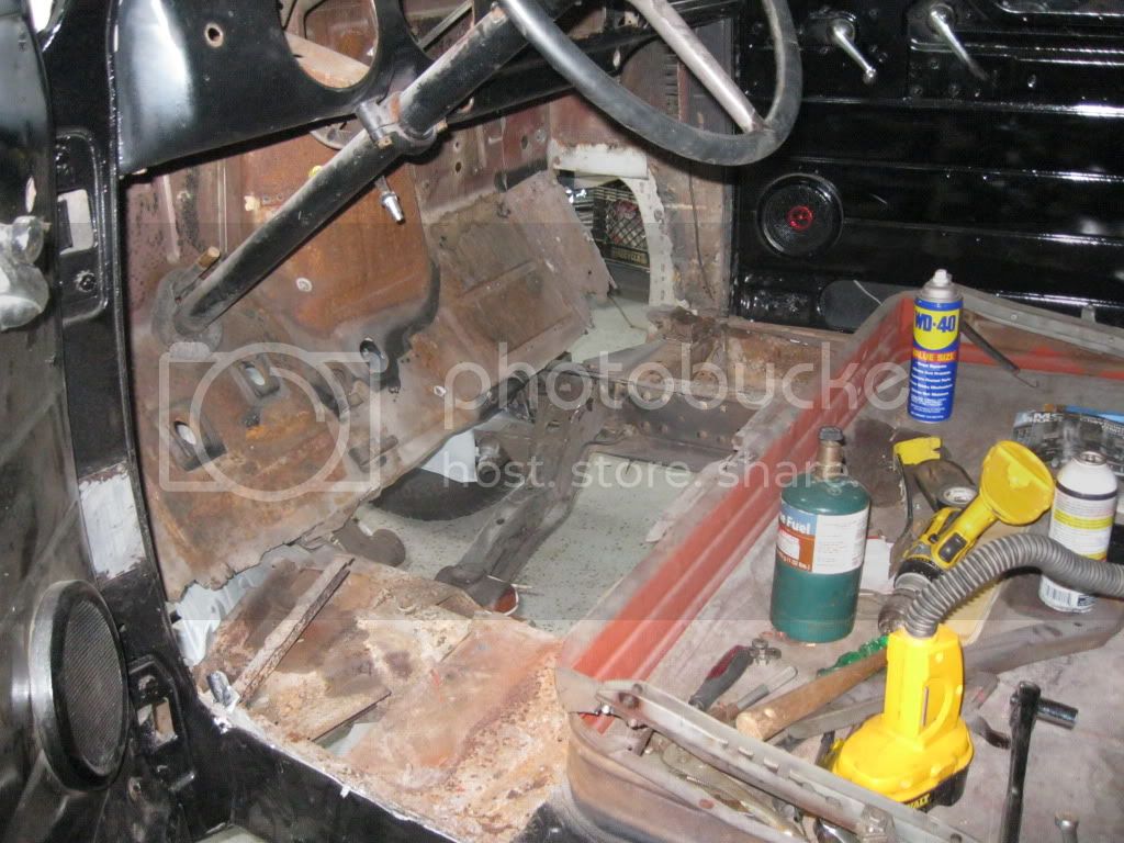

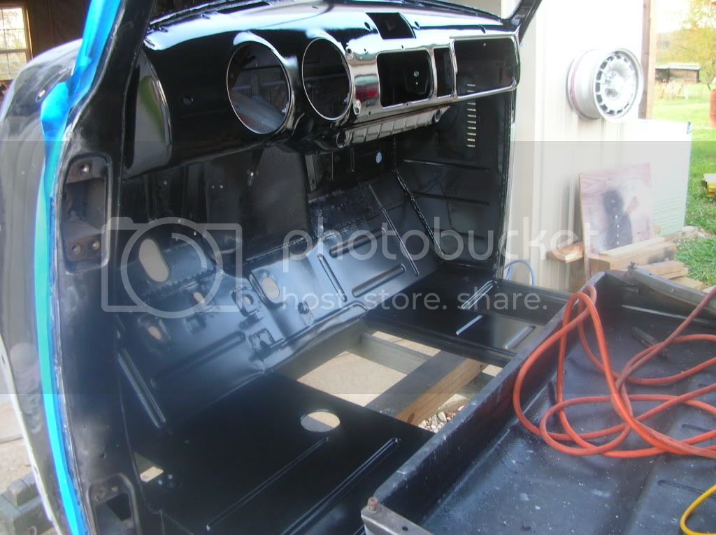

  10. coralhead
    coralhead Member
    Jun 8, 2012
    57
    S Indiana
    This is what was under the rubber mat.:eek:
    This is what is now under the rubber mat. :)
    That was earlier this year.
