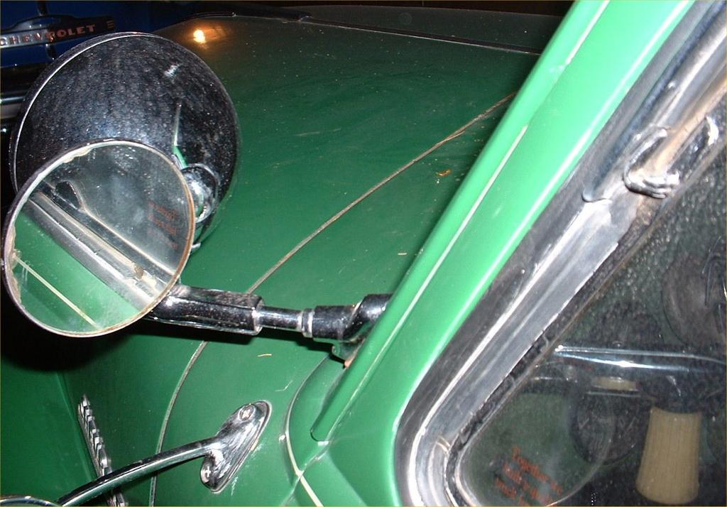

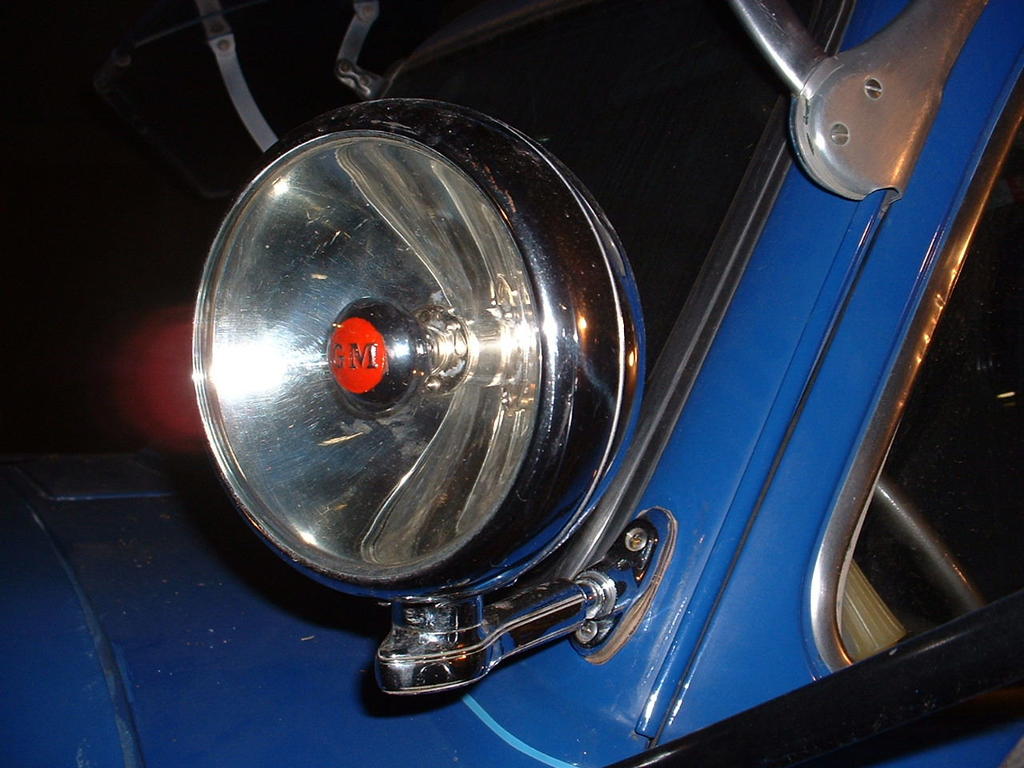

    Pictures 2 & 3 clearly show the location , the installation kits , they cost under $10 , will have a nifty paper template so you don't make a goof .
