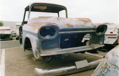

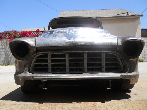

    My truck is a 58 cab with a 55 front end. You have to use the complete 55-57 front end if you want the single head lights. The firewall hood hinge holes are a little different but not a big deal. The 58 frame is about 2 1/2 inches longer in front of the radiator supports. Just mount the fenders and cut it off. Its and easy swap and a lot of people have done it.
    From this
    To this
