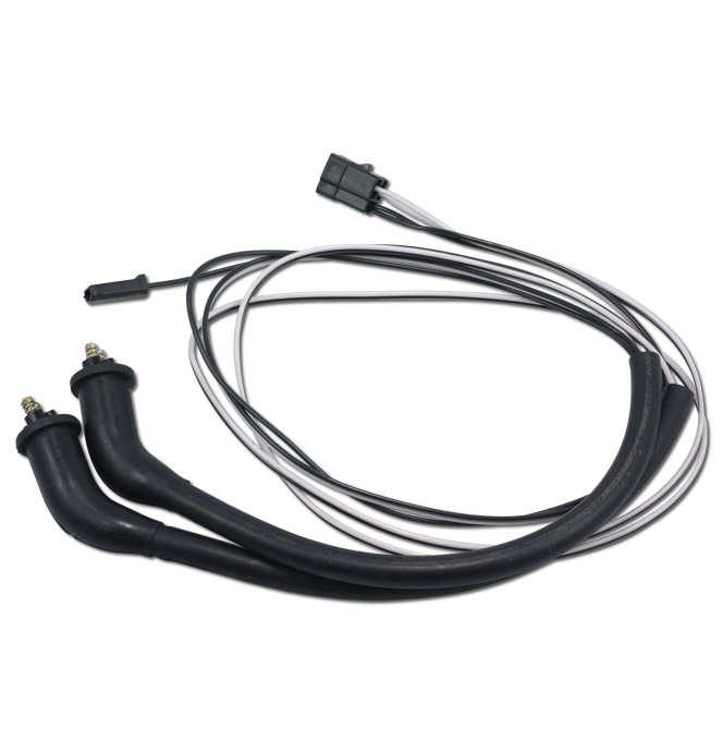

    O.K. , I assume # 52-662 is the sub harness to the taillights at the back of the truck ? . (pix or link to pix helps a lot here)
    It's been a few years since I worked on a '66 but , IIRC the harness you're looking for is part of the main cab wiring loom / harness from the firewall ~
    Perhaps a copy of the harness and plug you have , will help folks decipher what you need .

    sorry about the lack of pictures. Lets see if this works.
    here's what I have connected to the light sockets PN 52-662:
    you can see the square plugs that go to another harness as you move forward towards the fire wall.

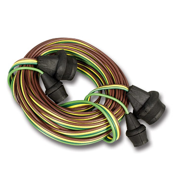

    Here is what I believe to be the next part of the harness which according to the website, goes from the firewall to the rear of the truck PN 52-623:
    It looks to me like this is a round connector where the tail light harness is a square connector. Is there something that 'marries' these two together? Thanks for the help!

    Bob the round plug appearance outside is actually square on the inside, I`m looking at mine right now.
