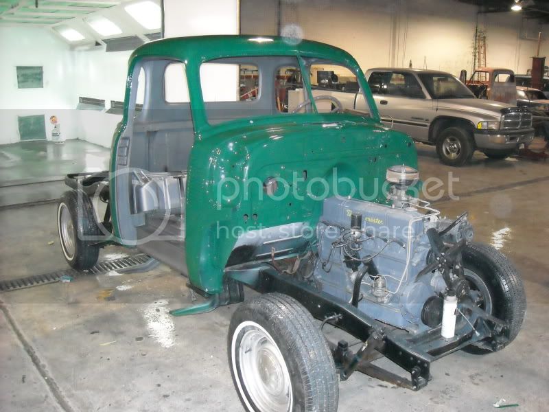

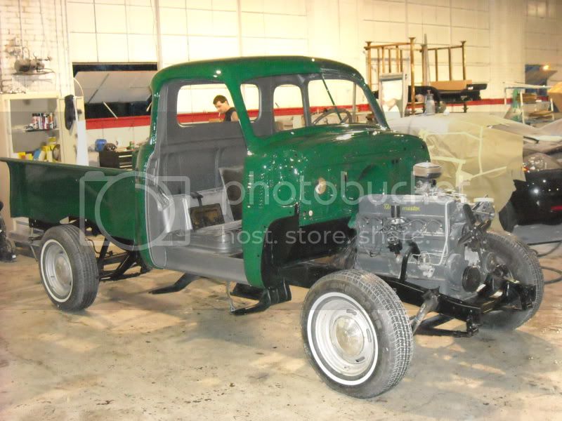

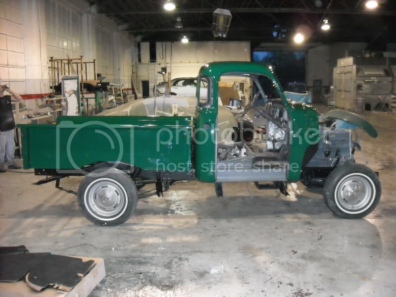

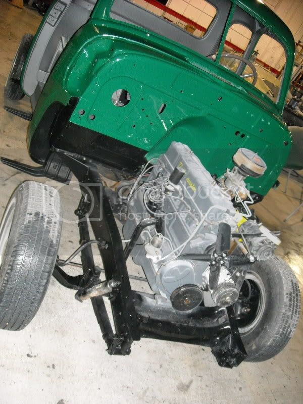

Here it is emerging from the booth. We cleaned and blacked the frame, under coated under the cab, and now it is time to start assembly! I will update as the build progresses.
Oh Yeah! Let's see What word describes it best? Sweet? Beautiful? Awesome? Purty? If I had to pick one, it would have to be...ALL THE ABOVE! Way to go man!! Keep the pics coming!
