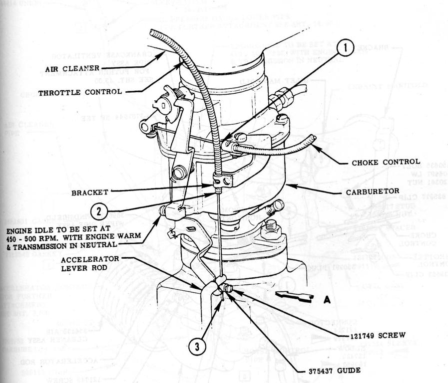

    Our truck has the throttle knob and cable in place but it is not hooked up to the carb. I cant see where it would hook to. The truck is as old as I am and it has probably forgot it to. . My son went through a set of spark plugs in 500 miles keeping it choked to much. If I can get the throttle to work it will help him out.

    There should be a little sheet metal bracket that holds the end of the throttle cable vertically , the center portion goes through the end of the throttle lifting rod , you prolly have a cotter pin there now .
    Then there's a cable clamp that simply sides on the end of the wire and has a set screw in it..
    Some once posted pix of this , then it's simple to see what you need , on my '49 I was missing the entire bracket with clamps , I bought a $5.00 Flea-Bay carby for the clamp and happily received a dry mesh original air fitler with it ,the spare carby core was a plus .

    1947-1954 factory assembly manual section 6, sheet 5.01

    Thanks Chiro. I think my cousin has one and will give it to me. I found a GMC manual that shows a different bracket, simple enought to make by hand. The one in your picture is much nicer
