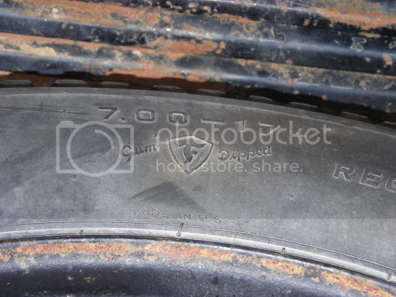

    :eek: i took the spare tire off today, for the first time ever. it does not match the tires on my truck, rather, it's the old split rim type with a vintage tire on it. anyway, i never really took the time to check out this old tire until today. does this mean my split rims are 17"??? and how does it measure out, because from one end to the other, it's not spot on. maybe there's something i don't know. could you guys enlighten me? thanks!!

    i measured the inside of the wheels today, and they all add up to 17". is that normal for a 3/4 ton? thanks!

    I dissected one of my original tires and wheels today. I had always been told that my 1 ton had 17 inch wheels. This is a pickup so it is not a dually. These wheels are the split rims just like you see on the 3/4 tons except bigger. The discovery was that the tires are 8X17.5. Would they have mounted a 17.5 tire on a 17 inch rim? If I measure across the area where the bead fits it is 17 inches. The overall height of the tire is 31.5 inches.

    My measurement shows 5 inch from inside flange to inside flange and that is what the specs say so I think I understand now.
