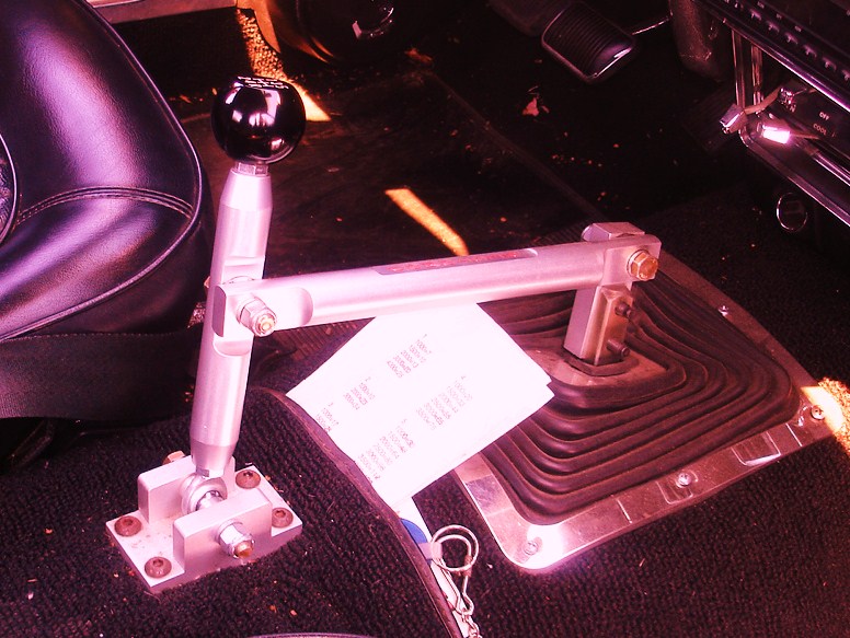

    This is a kit a buddy of mine bought to bring the shifter closer to him in his Mustang 351/5 speed. The same idea could possibly work on a GM 4 or 5 speed in one of our trucks....Big Tim :cool: 003.JPG

    There are quite a few articles on the T5 swap on the internet. Some even on our AD's. Russ is right the S-10 has a mid-mounted shifter and comes out not too far away from the standard opening. The Mustang shifter has a two hole shift lever mount, so any custom made or modified shift lever would just bolt up. Now lets see if I can find one for the $50-100 they say.
