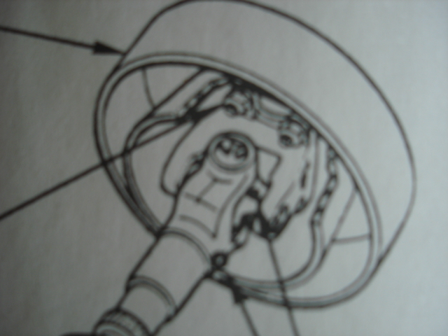

Hey gang, One of our members "millerd" was kind enough to donate his 58-235 and tranny. This will replace my old 48-216. The tranny has the parking brake on it and I'd like to convert my cable system to the drive shaft brake. I need the U-joint yoke at the tranny (see pic). Any Help?
Well ; That yoke was used past the 1968 model year that I know of... You understand you're going to need to change the entire rear end now too , right ? . No more Torque Tube .

Panic Just curious! Still not sure how the torque tube works but my 1 ton doesn't have one. Yes, I have a floor shift and P-brake lever. All this from the 58should fit fine. It appears, after reading, the yoke I need was available starting in 51 with the 1 1/2 ton? I'll be upgrading to the 12v system as well. Thanks, Rick
If the looooong bed is like my 3/4 ton, the torque tube goes to a carrier bearing, then turns to an open shaft. You will just have to have an open shaft made to go to the carrier bearing. The torque tube is a solid mount tube that goes to the rear end that houses the drive shaft. Modern vehicles use an open drive line.
