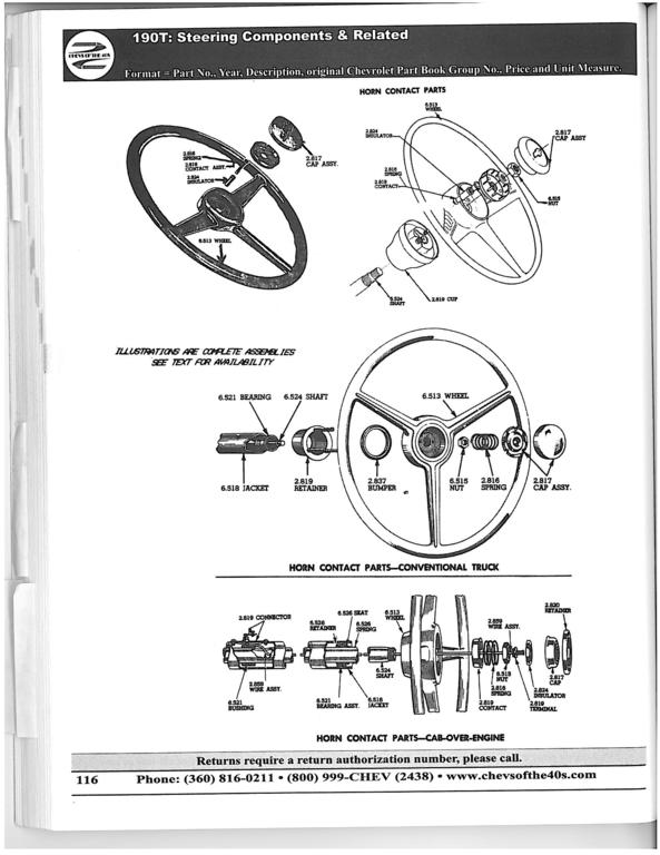

    I installed the old type horn today wich functions well. Testing the horn button function no sound whas coming . I made a check up with the inside parts in the steering wheel. Maybe some contact inside whas out of position or damaged ? I pulled of the horn button cap assy and did `nt found anything damaged. I found out that the 2 contacts where out of position.
    What i did. Removed the tighten nut and washer so i could move the contact in position wich is right above the lower contact/spring assy ?
    Put the washer in place and then tighten the nut again, mounted the cap and pressed. Then the trouble came as the horn constantly works and wont stop when i press. The cap function seems to work fine and even when i move the contact assy a bit it still gives me trouble.
    I looked up in sect. 9 sheet 1.00 in the Factory ass. manual and could `nt find any parts that are missing.
    Did i overlook something or mounted it the wrong way back again ?
    Great if someone can give me some advice , Martinius.

    Been a long time but I think there is a thin concave washer with three holes (<> 12mm) and three slots. If this washer is upside down or has lost some of it's curvature the horn will honk even when button isn't pushed.

  7. Larrys 48
    Larrys 48 Member
    Dec 7, 2007
    617
    Spokane, WA
    Photo worth a 1,000 words?
    Martinius - Maybe this will help? ;)
